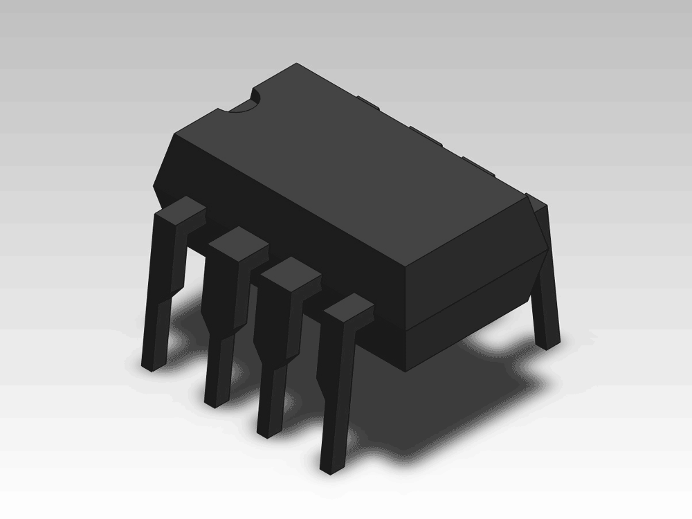

Step 1: Design
This design was made by reverse-engineering a physical 555 timer IC then building it in Soldiworks at the larger size. It was then edited and sliced into 3/4 inch thick slices.
I have included all drawings in downloadable PDF form as well jpeg copies in this and other steps.
The included PDF copy of the stencil is also necessary for the detailed painting of the part number in later steps.
