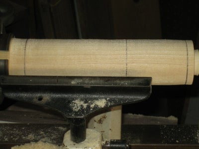

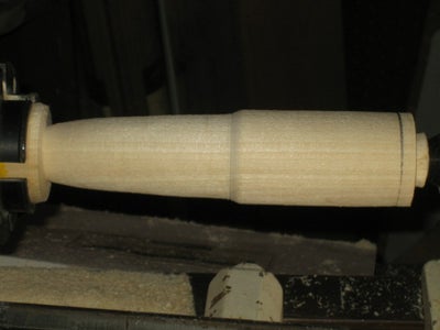

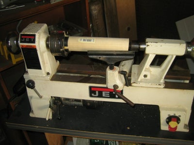

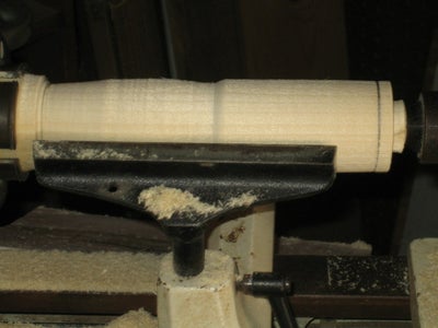

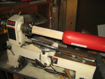

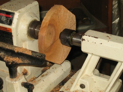

The best (and easiest) way for me to make the tip and bottom was to turn it on a lathe.

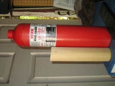

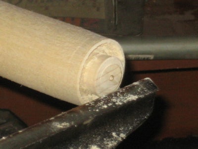

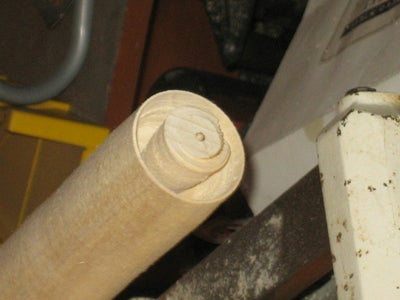

First start with a length of 2 inch dowel that seems proportional to the body of the "bullet." I had a .270 win bullet as a model to work off of and started on the part that will be attached to the body. I use a parting tool for most of my turning and I used it to hollow out a portion of the dowel that would slip into the opening of the fire extinguisher. Then, using a pencil, I marked where the beginning of the actual bullet portion would start. After marking the line that I was happy with, I used the parting tool to start shaping the tip of the bullet. As soon as the tip was close to being finished, I used 220 sand paper to sand out any major scratches. After being happy with the turning, I cut it off and sanded the very tip smooth to get rid of the cut off mark.

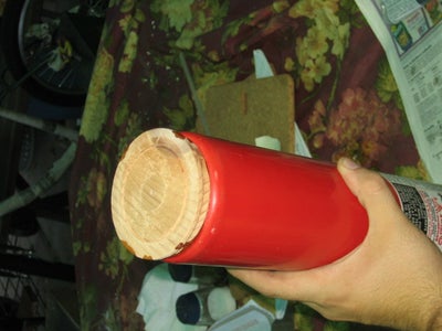

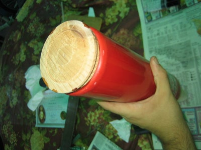

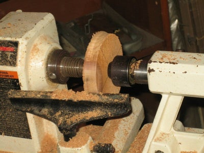

The bottom of the casing, I used a scrap piece of cedar fence board and turned it between centers. After making it round, I started work on the portion of the wood that goes against the bottom of the fire extinguisher and then began shaping it to the final shape. The gap between the wood and the fire extinguisher will be covered with air drying clay after their epoxied together so I didn't care if it was perfect.

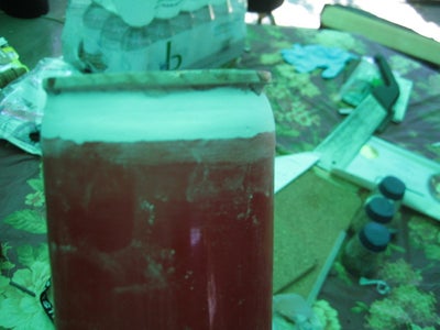

Step 4: Epoxy Everything Together

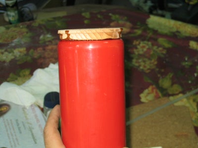

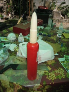

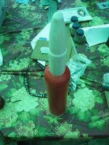

I epoxied all the wooden components to the metal fire extinguisher using 5 minute epoxy. The first part I epoxied to the fire extinguisher was the wooden tip that was turned on the lathe. I stood the fire extinguisher vertically and put the tip on. I viewed the tip from all angles in order to see if it looks straight. After making sure it was straight when viewed from all angles, I allowed the epoxy to dry.

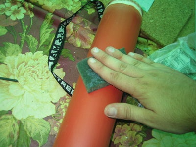

The next piece that was epoxied to the fire extinguisher was the bottom of the shell. After making sure that the bottom of the shell was straight and epoxied, I used a piece of clay in order hide the seam between the metal extinguisher and the wood. Then, I let it dry and used a scotch-brite pad to smooth and blend everything together.

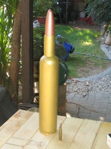

Step 5: Painting

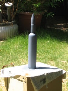

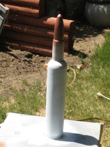

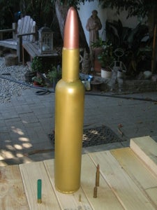

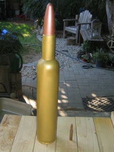

After sanding the whole piece using a scotch-brite pad, I used gray primer and gave three coats to the piece. I then used copper colored spray paint to paint the bullet tip. The tip had about three coats of paint. After letting the copper color dry, I taped up the tip with masking tape and then sprayed the whole piece with three coats of brass colored spray paint. Letting the brass color dry for a few hours, I remove the masking tape covering the copper paint and then sprayed the whole piece with an outdoor clear coat. The clear is about two coats.
I then came up with the idea to use stickers to write "STUDIO PROP" where the information for a real bullet would go. I did this because I don't want someone to call the bomb squad on my bike if I have it locked out front of some public place. I recommend doing this if your going to have this prop out in public so that the bomb squad does not destroy your prop.
