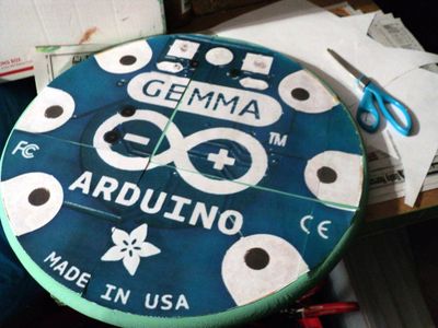

Step 2: You Need to Rasterbate More Often...
There are many ways to enlarge your image and print it out. No need to take it to the office supply place to print out a poster. It is a tedious task in GIMP.
I used rastebator.net online to enlarge my image, free but please donate to the author
You can upload your image and they will process it into a pdf you can download to print.
Choose file and upload.
Select Print yourself and adjust paper size US Letter, leave default margins
Adjust output size 2.25 Since my round tabletop flat was 17.5 inches, convert that to centimeters (44.45)
Play around to adjust the printout size. Watch the poster size change and get it close to the size you need. You can enter in fractional page widths so I ranged my number to 2.25. Use the field artillery method of estimating by taking your far and near measure. See where you are at. Use the halfway point between your estimated start points and see where to adjust up or down from there. Repeat the process. With a minimal amount of tries, you can home in on the target...
Once you have printed it out, carefully trim the excess paper off.
Dry fit on your tabletop.
You should now be ready to apply the Modpodge or thinned out glue to decoupage the image onto the surface.
I have found that you have to work fairly quick because the glue gets tacky and it is hard to reposition things if needed and the water in the glues will warp and bubble the paper. Things might be difficult to line up or match exactly like when you did the dry fit. Maybe that's why they sell a special formulation of Modpodge for paper crafting.
You can then top coat everything and set aside to completely dry.
Step 3: Holey Moley...
Take a spade bit to drill out the holes in the giant circuit board.
Drill over a scrap piece of wood under the hole to prevent the bit from tearing out the exit hole.
The holes with a large spade bit tend to be rough so you can sand smooth or just pick out the loose pieces.
Mine came out to 3/4 inch diameter with no known AWG size to fit that.
Make sure your plate the thru-holes with silver paint and a coating of Modpodge.
