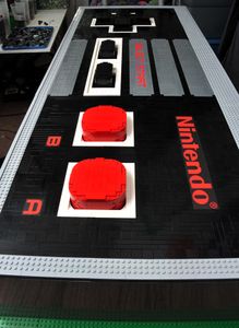

My most ambitious LEGO creation yet: a large 5-foot sculpture of a retro Nintendo Entertainment System controller - that’s actually rigged up with wires and switches to work!
Click here to see the full article.
Initially conceived in the late summer of 2012, this titanic brute has been gradually worked on since the past months and finally completed towards the end of 2012. Various issues, such as work-related and/or financial problems halted its production, but nonetheless I managed to complete this giant controller, in both its LEGO structure as well as electrical functionality.

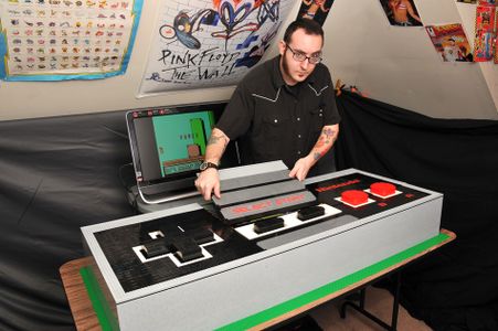

Resting atop a large folding table in my attic workshop, the controller is built of light-grey LEGO brick walls with removable tiled plates for the ceiling. Like previous works, I’ve used custom glossy stickers for the labels. The innards are mainly hollowed with some trusses and support for the buttons; the buttons are spring-loaded modules using LEGO Technic pieces to make the large buttons reciprocate when pressed. Below the large LEGO buttons are small momentary pushbuttons soldered to the actual circuitry board of an original NES controller, which is then linked to a USB converter to play Nintendo ROMs on my computer. When the large LEGO buttons are pressed, the bottoms make contact with the pushbuttons, which then send the electrical signal back to the controller’s circuit “brain”; the LEGO Technic spring suspension system prevents the large buttons from getting stuck in place.

Like every other LEGO creation I’ve made in the past, I first checked Google to see if anyone has ever built a giant NES controller from LEGO bricks. I discovered that giant functioning NES controllers were nothing new - in fact, around 2008 there was a significant fad of people in the U.S., U.K. and Australia constructing giant 5-6 foot operable NES controllers to use as coffee tables. I said to myself, “Well, I guess this means I definitely won’t be the first person to make a giant working Nintendo controller… But that doesn’t mean I can’t be the first to make one out of LEGO bricks!” And thus I began mapping out the controller’s specs, keeping it in proportion to a real controller, enlarged and made almost perfect to scale (give or take by a few centimeters, depending on the size available of LEGO units). In fact, every detail on my controller, such as the placement of the buttons, the size of the text in “Select and Start”, and the location of the dark grey middle stripes were constructed virtually in sync with a real controller, only slightly off and/or adjusted to compensate for thickness of LEGO pieces.
First I built the buttons; I purchased a large parcel of Technic shock absorbers to use as a suspension system for keeping the heavy buttons held in place. The A, B, Start and Select buttons are made of rounded bricks, whilst the D-pad is a square plus sign resembling a German Balkenkreuz. Coming up with a way to integrate the momentary pushbuttons with LEGO parts was difficult, as I try to avoid glue, cutting and sanding when possible. While watching Ghostbusters 2 one night, I figured out how to keep the Radio Shack buttons in place by having a small LEGO chassis to hold each button down, with clearance for the wires to slide out the front. The large buttons would slide up and down and make contact with the small Radio Shack buttons held in the small LEGO holders I rigged up.
Next came the construction of the outer walls and the base: I used several 32 x 32 green baseplates on top of a large folding table, and constructed the four walls from thousands of light-grey bricks. Fun fact: if you call up the LEGO Stores and request to purchase an entire box of one type/color of pieces [used mainly for store stock in the Pick-a-Brick section], they’ll sell ‘em to you for $70 each with free FedEx shipping! Let’s say you want to make a giant LEGO castle, you could easily get a few $70 boxes of entirely grey bricks, rather than sorting through pieces online. Thus, I bought about six or seven boxes of light-grey 1x4 and 2x4 bricks to make the walls. The original concept was to make the roof completely in a fixed position, with doors on the front wall of the controller to make any repairs internally. I realized this was an inefficient method; thus I removed the doors, made the front wall solid, and the roof detachable in five large reinforced plates with tiles and stickers for design. If you look at the work-in-progress photos in my previous Tumblr posts, you’ll see the early stages before the ceiling, when the doors were in place and the innards of the controller were fixed with beams/trusses to support the eventual ceiling that I scrapped.
The walls have the most pieces, but surprisingly didn’t take too long to put up. In fact, I slapped each brick-on-brick together like masonry bricklaying, and with its flat rectangular shape with little deviation, I breezed right through assembling the four walls. As mentioned previously, I had at my disposal several boxes of solid-color bricks I purchased in bulk from the LEGO Stores in New Jersey and Long Island; piling on the light-grey bricks meant simply dipping in the boxes and repeating the brick-on-bricklaying method. The ceiling plates took a while to build, however; they had to constantly be removed and adjusted to slide in place securely. I also had to keep reinforcing the under portions of the roof plates to make sure they didn’t warp in the middle. The tiling process was also very tedious and time consuming.

I recall vividly the day I rigged up the wires successfully: I stayed up all one Friday night making a mess with solder and speaker wire, to create a beast of a tangled slapdash electronic circuits as I listened to my classic rock mix playlist in my attic workshop. The next afternoon, I hooked up the USB-out end of the controller to my laptop, put on the theme song from RoboCop, loaded up a Contra emulator ROM, calibrated the controller’s buttons, and voilà: history was made! My seemingly chaotic jerry-rigged wires and alligator clips attached to a 25-year old Nintendo controller were fully-operational, much like the Second Death Star! Then after much scrambling to find a good photog in time, I managed to just now get this massive controller officially chronicled and put online for your viewing pleasure!
