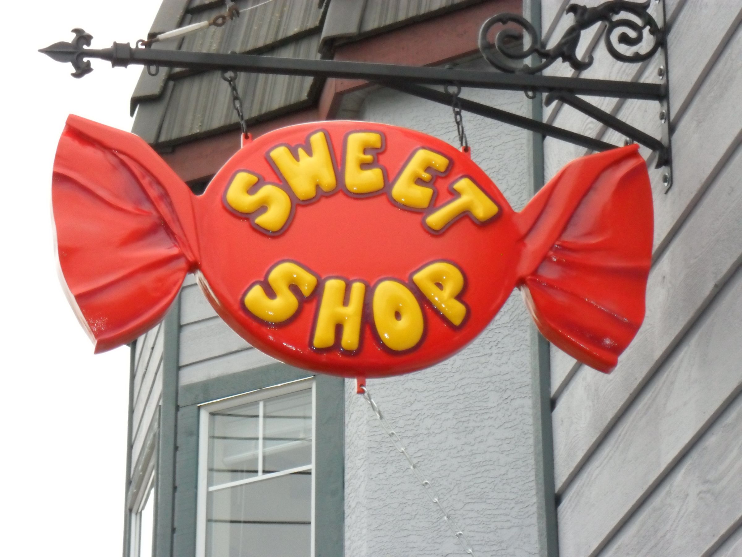

It's a 2ft diameter x 4ft high x 4in thick Lollipop!!!!
It's made out of HDU (High Density Urethane) Design Board.
I designed it with EnRoute software...then carved the two halves on my home made CNC Router...then the two halves were glued together with an aluminium framework sandwiched in-between for support and to act as "the stick"...then I cleaned it up by hand and did some final carving by hand...then primed it...brush painted it....airbrush painted in some shadows...then applied 3 coats of sparkling clear coat.
Hope you like it!
