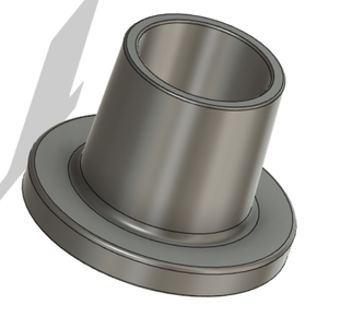

One of the key things I was designing for with this table was that I wanted it to be able to be easily moved without the use of a pickup truck, so I wanted make sure it could be taken apart. These endcaps solve that problem. Now, you can easily weld thick, flat plates to the ends of the tube and drill holes in them and it would serve the same purpose. If you choose to go that route, feel free to skip to Step 4! However, since I'm not great at welding round things and didn't have any thick steel plate lying around, I decided to sand cast them from aluminum.
The first step is to design and 3D Print a pattern to make the mold. The pattern can be made from wood or other materials as well, but 3D printing is preferable if available. Just be sure to add draft!
If you wanted to go with my design, I've included Fusion 360 files as well as STL files here. Note that I had to print the flat part in two pieces in order to accommodate my printer's small build volume. They don't need much infill - I used 20%, but I did make sure to use the finest resolution possible. This helps when pulling the casting from the mold.

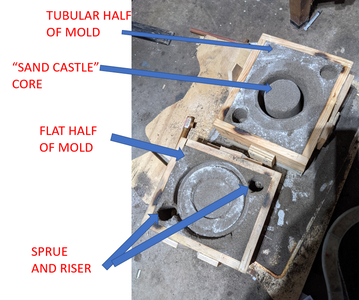

The next step is to make the molds for the endcaps. Before beginning to ram up a sand mold, I always coat my parts with as much baby powder or talc as I can get to stick to the surface. This helps release the patterns from the mold.
Starting with the flat part of the pattern, ram up your mold with two 1" dowels (or other round thing you have) on either side of it (these will be our sprue and riser). If you're using my design, be sure the recess where the tubular half nests into the flat half is facing the ground as you ram. This is the recess shown in the second picture of Step 1.
This may be bad practice, but in order to make the molding process easier, I covered the open end of the tubular portion with tape to prevent any sand from getting in. This makes it easier to pull out after ramming that half of the mold.
Once the flat side is rammed up and the tubular end is taped off, flip the flask over, and place the tubular end of the pattern in the recess in the flat half. Coat the sand in the flat half of your mold and the tubular pattern with baby powder, and ram up the rest of the mold.
Pull the halves apart, and very carefully remove them from the sand. To make this easier, I like to use small wood screws drilled into the surface of my patterns to make them easier to grab. If they're being extra stubborn, give them a few taps with the end of a screwdriver to help loosen them up.
Now that the tubular portion is out, you can remove the tape and use the hollow area of the pattern to make a "sand castle." If you pack it tight and your sand is tempered well, you should be able to use this as a core which you can drop directly into the hollow left in the mold by the tubular pattern.
At this point, all that's left to do is cut gates from the dowels to the inside of the mold, and you're ready to put the mold back together and pour!
