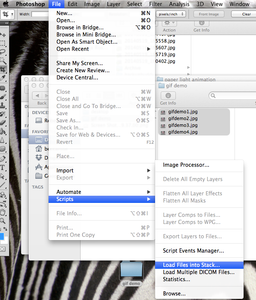

Open Photoshop, and import files as layers to one image, go to: file ---> scripts ---> load files into stack.

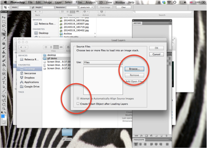

Click browse and select the images you organized in step 1.
Be sure to check “attempt to automatically align source images”. This will align all your images to the best fit, and save you a lot of time (I used to line up all the image by eye and it took AAAAAGES!). When you've checked the box, hit OK, and images will open as multiple layers in one image.

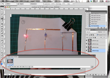

Now to make the animation (yipee!). First get the animation window up: window ---> animation.
Step 5: Animation Frames

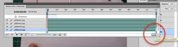

The animation window will open somewhere on your screen, this is where you will create the animated gif.
Note: sometimes when you open the animation window it may not open with frames automatically, and it will look like the image below. If this is the case, choose “convert to frame animation” in right bottom corner.

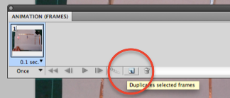

Each photo in your gif will be a frame. You can use as many frames as you like, but remember the more you choose the bigger the file will be (and slower to load).

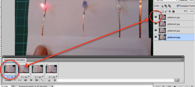

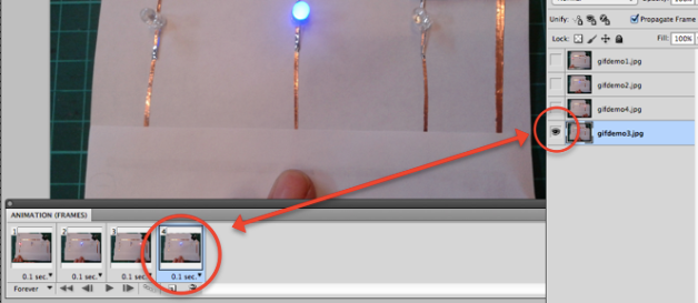

The animation window will open with 1 frame. To create more frames, click the duplicate frame box to add the desired number of frames (in this case 4). To create the animation add your layer sequence to the 4 frames. Make sure that the layer is visible on the frame by clicking (or de-clicking) the eye icon. Getting this right it the trickiest part.
i.e.
1st frame = top layer is visible
2nd frame = 2nd layer is visible
3rd frame = 3rd layer is visible
4th frame = bottom layer is visible

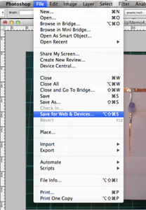

Step 9: Saving

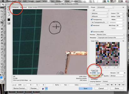

Now you’ve made the animation, and need to save as a gif file. Go to file --> Save for web and devices.
Step 10:
Use the same preset options as the image. If you have a large image, adjust image size (If you are embedding in a blog or Flickr, you will need to add the media in it’s original size, else it does not function properly. So choose a good width for viewing. I usually go for a width of 600 to 700 px). Now hit save. Congratulations -you’ve made a gif!
