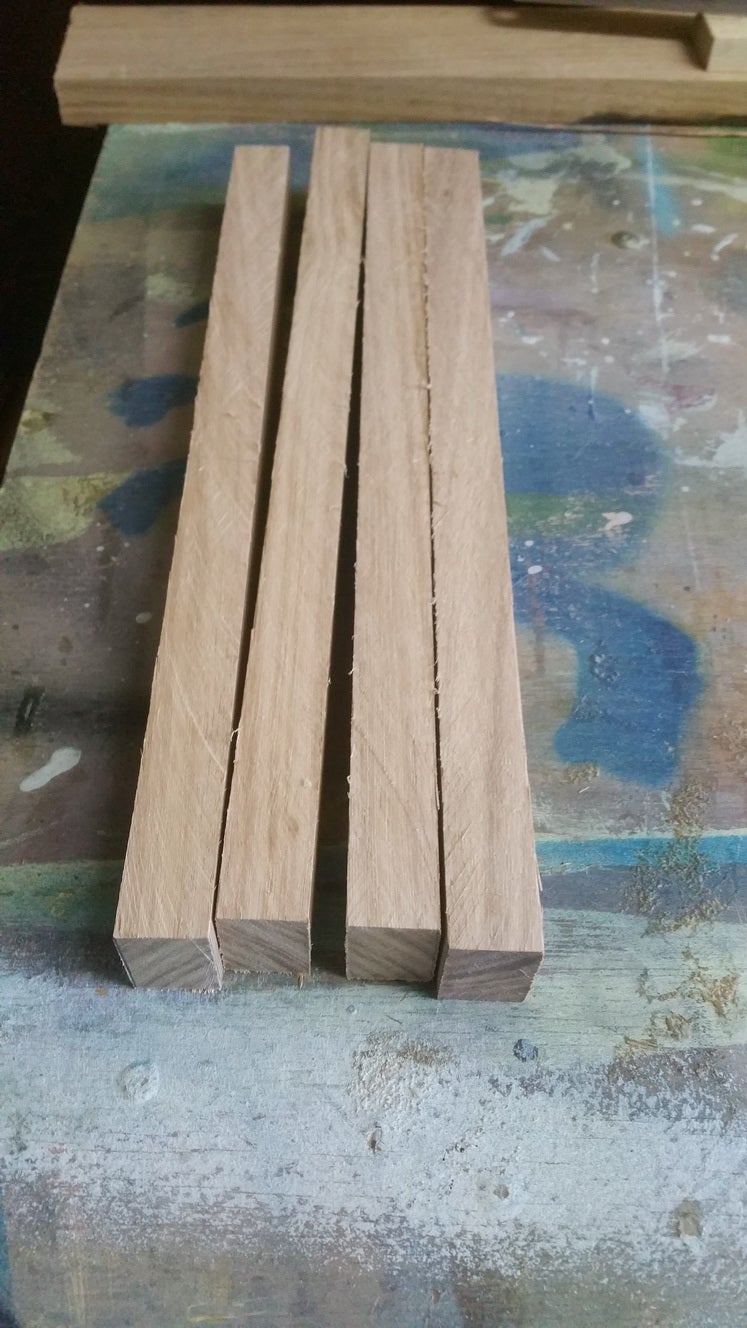

I used scrap Oak that I had left over from another project. It measured 30 x 19 mm which is not a standard width. You will need to consider how thick the plaque is and if there will be a gap between the glass and plaque that little bits coffee beans can fall between. I made sure my plaque sat flush against the glass to avoid this.
- 4 pieces of Oak: 30 x 19 x 300mm long to make the sides. I like to start with a little bit more then I need when cutting miters to allow for any error and help get a perfect fit. You will use these 4 pieces to make the following:
- 2 x Long sides: 30 x 19 x 280mm Oak
- 2 x Short Sides: 30 x 19 x 230mm Oak

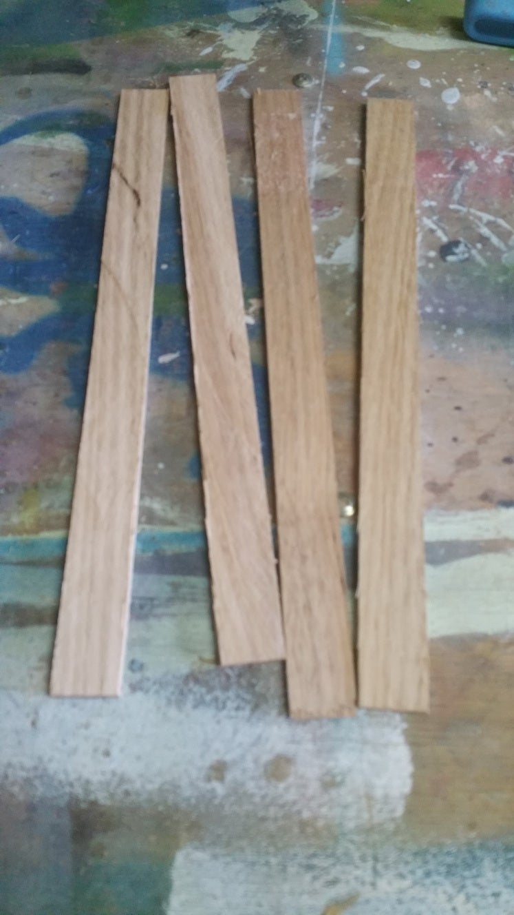

- Off Cuts - don't throw out the off cuts you will use these to make the spacer between the glass and back

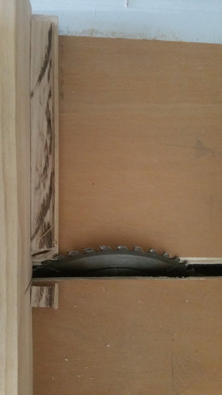

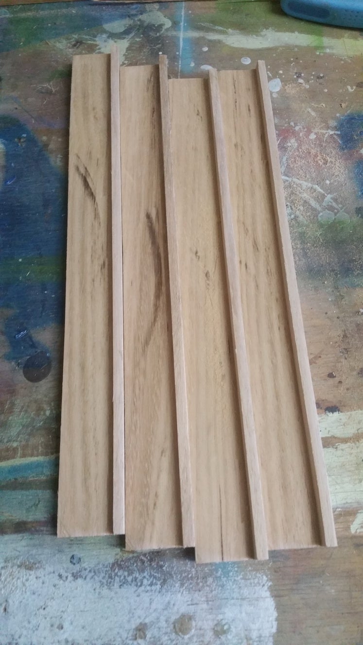

- Using the table saw I cut a grove 5 mm in from one side of each piece.
- I then lifted the blade so that I could remove the waste and be left with a ledge that the glass will sit on.
- Put the pieces of timber you removed to the side as these will be used to make the spacer between the glass and back of the frame.

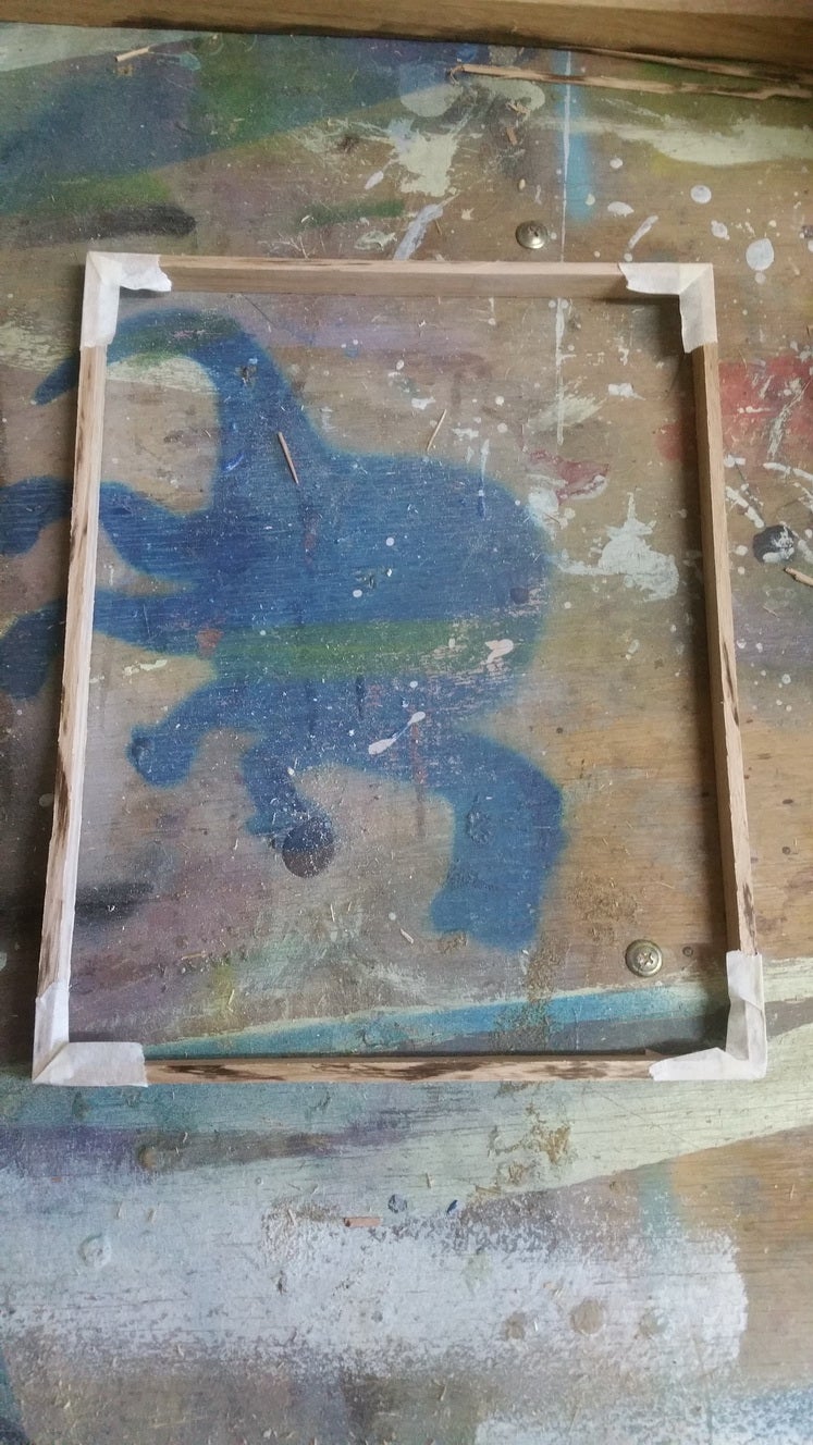

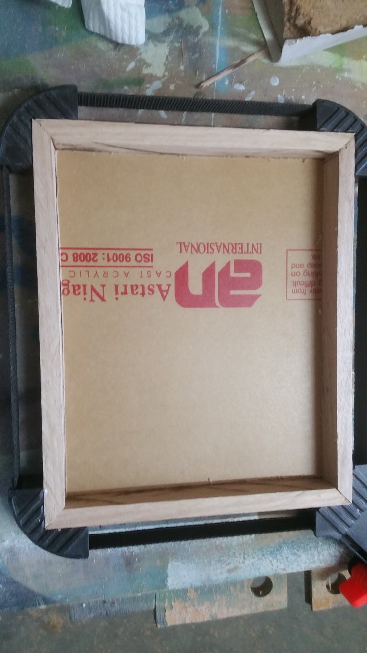

Step 3: Cut the Miter Joints and Glue the Frame
Using a table saw sled I cut a 45 miter on each of the sides, making sure I tested and dry fit to ensure everything was square and the glass and acrylic fit correctly.
Once everything was fitted and squared I used a band clamp to glue the frame together.

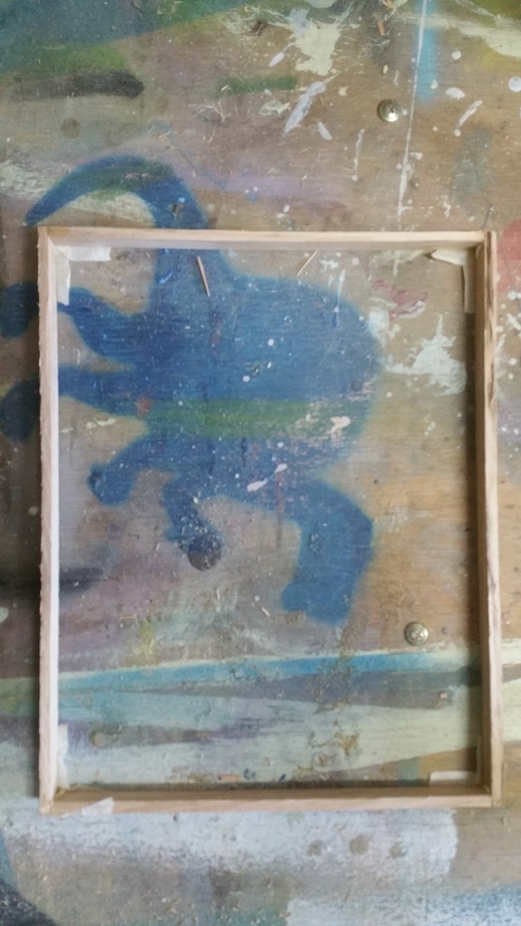

Step 4: Create the Spacer

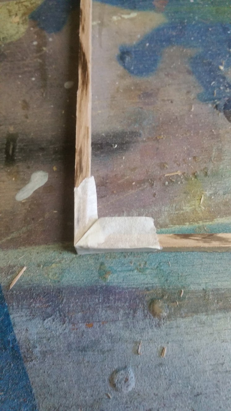

Using the frame as a guide I cut 2 of the off cuts to length. I was then able to cut the other sides to fit, ensuring that the front of the spacer would not be seen through the front of the glass.
I just but joined these pieces and used masking tape to hold while the glue dried. They won't be under much force and only need to space the glass and backing board.

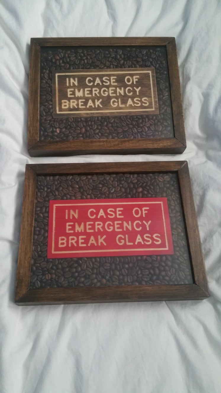

I wanted the frame to match the coffee beans so I used some stain I already had called "Black Japan". I used this and a red stain to make 2 plaques, I wanted to see how they both turned out. I don't have the name of the red stain but it was a wipe on thick paste.
I applied the stain to the frame, inside of the spacer and the back. I also applied it to 2 scrap pieces of plywood to prepare for carving with the CNC.
Step 6: Create the Plaque
Using my Shapeoko CNC I carved "In case of emergency break glass" and cut out both plaques. I went over the edges of each plaque with the matching stain (only shown on the red plaque).
Once these were complete I went over everything with clear satin varnish.

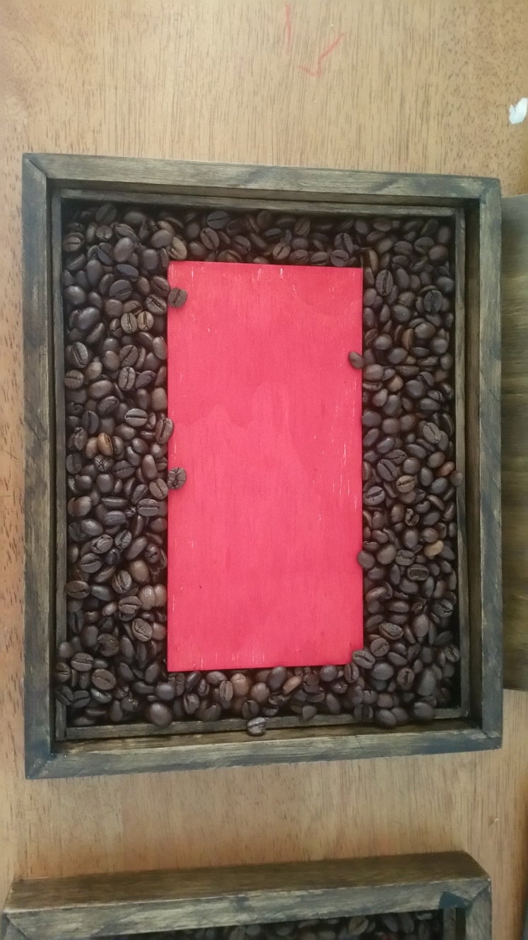

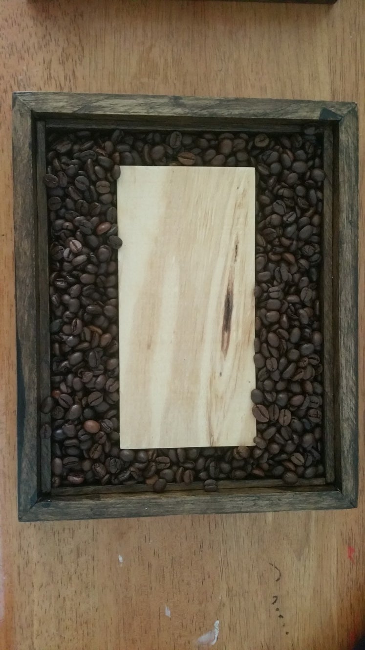

Step 7: Assembly
- With the frame upside down insert the glass and then the spacer.
- Add the plaque and use a ruler to make sure it is centered.
- Fill the space around the plaque with Coffee Beans making sure not to bump the plaque! This was the hardest part, if it wasn't for the great smell of the Coffee Beans I would have probably gave in and tried to somehow glue the plaque to the glass.
- Once you have filled with coffee beans and they are level with the spacer use hot glue on the back of the plaque and insert the back to help keep it in place.
- Use small nails to hold the back in place on the frame.
- Attach a hook to hang it off the wall and you are done!

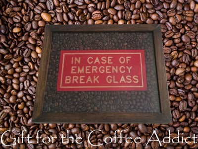

Step 8: Complete!
These were fairly quick and easy to make and there are other options for the plaque for those without a CNC. The red one was used as my secret Santa gift and I have kept the other to put beside my coffee machine.
