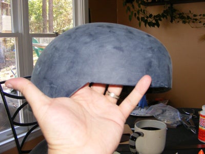

The first step in making the helmet was to cut off the bill and the ear cups of an old batting helmet in order to reduce the profile a bit. As the helmet was a tight fit for my son, I removed all of the foam padding from the interior as well. I used the patterns and some eyeball measurements to make a cardboard mockup of the helmet, just to figure out how the pieces would need to be scaled. Once I had the scaling information, I scaled the patterns and printed them at the final size. I also cut-and-pasted pieces of the cheekguard patterns together in order to make a pattern for the headband decorations.

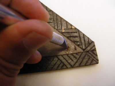

I then used the patterns to mark out the ornamental details onto more craft foam. For some pieces, I transferred the designs to the foam using light-colored carbon paper (available at any well-stocked sewing/fabric shop), and for others I just taped the paper pattern directly to the foam. Either method will work.
For the more intricately detailed pieces, I spray-mounted the foam to a piece of construction paper before cutting, to reduce the amount of stretching while cutting out the details. This seemed to help a lot.
The detail pieces were then cut out from the foam sheets using a very sharp hobby knife. Fine lines in the design were simply scored partially through the foam. This part took a very long time, and I think I have carpal tunnel now. Also, I can't seem to focus my eyes anymore.
The base pieces were pre-colored using a black fabric marker that I smudged a bit with my finger. The idea was to darken the background and make the color less uniform, to simulate the tarnished-metal look I was going for, and to add a bit of visual interest.

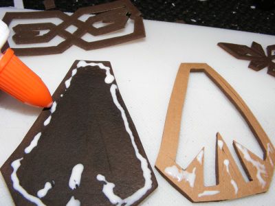

The detail pieces were then glued to the base pieces with tacky glue (foam glue would also work). When the glue was dry, the assembled pieces were ironed as above, and then the raised details were colored with Rub & Buff, using my favorite painting tool.

The base helmet was well-sanded to remove all gloss, the fins and disc were glued into place using E-6000, any gaps between the fins and the helmet were filled with a bead of hot glue, and the whole thing was painted Hammered Bronze. Holes for pop rivets were marked using the pre-punched holes in the skirt tab, then drilled. Then the skirt piece was mounted to the base helmet with pop rivets.

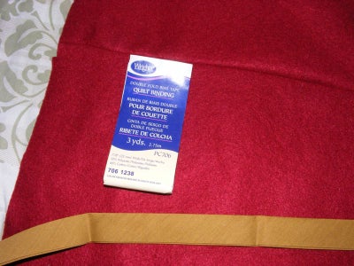

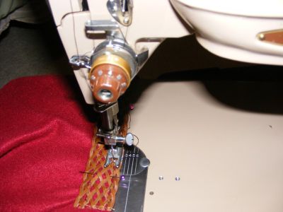

Step 5: The Surcoat
The base garment is basically a sleeveless burgundy bathrobe. I used a fleece Snuggie from Goodwill, because it was cheap and a decent approximation of the right color. I didn't use a pattern, I just laid one of my son's larger T-shirts onto the folded fabric and traced around it for the torso, flared the shape out from the waistline to the full width of the fabric, cut one of the pieces up the middle for the front opening, then stitched the sides and the shoulder seams together. After it was assembled, I put it on my son over the chainmaille hauberk and marked the length (it should be a few inches shorter than the hauberk), then cut it along the bottom. This gave me my sleeveless bathrobe.
The front opening was edged with quilt edging bias tape in a tannish-goldish color. Then I added trim details made from two braided leather belts. One belt was cut in half and the pieces were used to trim the arm openings. The other belt was simply attached to the base garment about three inches above the bottom hem. All of this was done on my 1954 Singer sewing machine, which protested vehemently the entire time, but did not fail me. After the Gene Simmons boots from last year, it gives me dirty looks every time I take it out of the closet anyway....
The surcoat was finished by adding eyelets in the bias tape trim from approximately waist-level to the neck, and using a long boot lace to lace it all up.

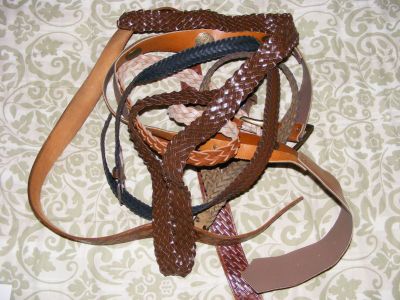

Step 8: The Harness/Bandoliers
The harness was very simple to make. Starting with a wide leather belt from Goodwill, I put it onto my son with the buckle in back (I was planning to make Gimli's belt buckle, but didn't want to bother with making it functional).
I took two more (reasonably matching) braided Goodwill belts and crossed them over his shoulders to be the bandoliers. I marked the belt and the bandoliers where they would need to attach to each other and punched holes with a leather punch. The belts were all attached together with cap rivets.

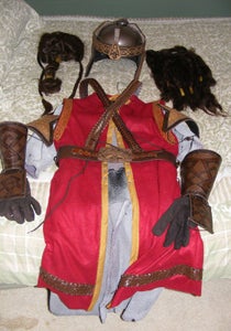

Step 12: Final Assembly
After the beard and wig, all that was left was to add the boots, shoulder armor, gauntlets, helmet and axe. Pretty much in that order.
Step 13: The Results
Here are a few shots of the costume in action. Once again, RavingChild entered the local downtown festival's costume contest, and once again, he won first prize. Last year's prize was a trophy (which was cool), but this year's prize was even better: a gift certificate to our local game/comic book shop. If I'm lucky, maybe he'll share it with me....
Happy Halloween!
