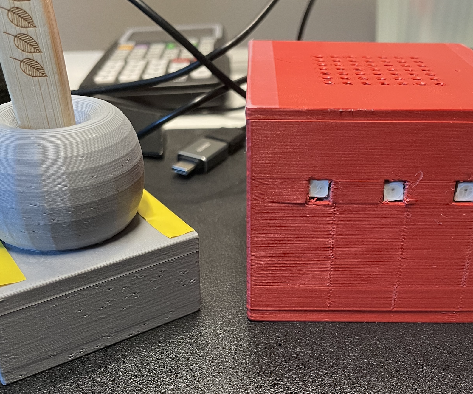

Step 3: Print Case & Grid / Cut Acrylic
This step is fairly straight forward, print the encasing for the light. The GitHub above contains STL files with the prints I used for printing as well as for reference. I would recommend tweaking them a bit because some of the measurement were a tiny bit off and the enclosure doesn't have a closing mechanism lol. I also cut a foggy acrylic panel to distribute the light slightly better. The measurements were just 72mmx72mm but I would recommend a little bit bigger to cover the entire face of the encasing. Measurements in the STL's in the GitHub above.
Step 4: Assemble
Finally, you can assemble your box, shove your pico inside, and plop the grid on the railings above it. Make sure the buttons stick out so you can actually interact with them.
