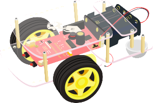

Step 1: Build the GoPiGo.
You can find a GoPiGo here. The GoPiGo Starter Kit includes everything you need to make a Raspberry Pi Robot.
The GoPiGo is quick to assemble and takes about 20 minutes or less with just a philips head screw driver. No soldering is required and no prior expertise required.
Check out the code and designs on the Dexter Industries Github repo. The GoPiGo can be programmed in Python, Scratch and Java.
There step by step instructions on building the GoPiGo here.

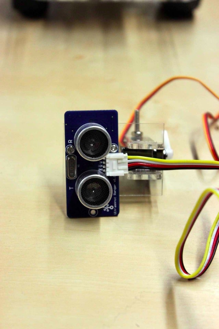

Step 3: Attach the GoPiGo Ultrasonic Sensor.
You should attach an Ultrasonic Sensor to your Raspberry Pi Robot. Instructions for attaching the ultrasonic sensor to your Raspberry Pi Robot can be found here.
