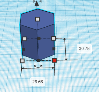

For creating our model for the game we start with a Polygon from the Basic Shapes; drag it on the Workplane. It will have default measurements. First we need to uniformly scale the width and length (see this 'Tinkertip' on how to do it) to about 26mm and 30mm respectively. If you are having trouble with scaling you can enter those values directly. Note that depending on Snap Grid setting it might not be exactly those values when you are done and I will leave it to you if you want them exact or leave them be from the scale operation, although I did change mine!

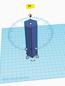

Next we need to change the height to 100mm. The way I decided this was to measure my hand which is about 90mm I upped this to an even 100mm go ahead and change this to that value or something you would like for yourself e.g. more if you have a bigger hand. This is so that the pencil piece sits snugly in the hand when throwing but also the text can fit in it.
Rotate

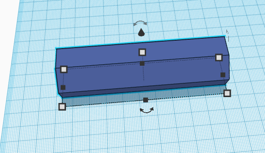

We then need to rotate to model so that it is laying flat on the Workplane for us to add text to it. Rotate it by either 90 or -90 degrees it doesn't matter as it gets us the same end result. On thing here is that the rotation should be either left (90 degrees) or right (-90 degrees) and not forward of backwards.
You will find that the model is now suspended in air and no longer touching the Workplane. You can press D on the keyboard and it will drop to the Workplane. This is a handy Tinkercad keyboard shortcut and see this link for more shortcuts.

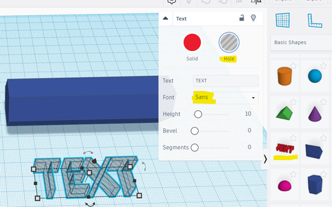

Add Text
We can now add text as required by the game rules - see intro for options. The way to do this is to add text at the top edge and then rotate. One suggestion here is to start off with to the Take All option i.e. the longest option, it will allow us to adjust anything according to this at the start instead of later on when there is more to change.
I say add text but technically we will change the text from solid to a hole type object and combine the two parts leaving an engraved pencil piece with writing on the top edge.

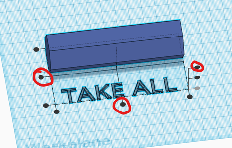

Drag the text object from the basic shapes to the Workplane, change the font to Sans (I find this tends to print better and is my go to font for 3D printing). Change the object from Solid to Hole as shown in the photo. Next, change the text to the Take All option and I suggest that you use capitals.
As you can see the text object is too big (or was for mine) so we need to reduce it so that it fits the top edge of the polygon aka pencil game piece. Use the same uniform scale method you used above until you get the text less than the pencil piece which on the side the width is now 100mm. I got mine to about 85mm which fits but this is to big for the edge so we need to reduce the length a bit, do this manually to make sure it fits OK. Mine was about 12mm and was a really good fit. The only remaining measure we still need to change is the height of the text so go ahead and change this to 1mm which is a good amount for the printer to inscribe text.
The next step will be to combine the two objects. Select the both of them and align them centre on both front and left/right sides and then do the top as well - order doesn't matter as long as its those three points (see photo). With both objects still selected press Ctrl + G or the Group button to group them, leaving you with only one object.

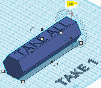

Whichever option you choose for creating the text for the next option we will need to rotate the polygon / pencil piece so that an empty edge is on top. We need to rotate the pencil piece and since it is a simple polygon with 6 sides we need to rotate it 60 degrees (360 / 6 = 60). Once you have rotated the object you should be able to add the next text on the top edge the same as above. Don't forget to align them before you group the two objects.
At this stage it is a matter of rotate, add text and group and repeat :). Once you have all 5 options on each edge ( remember one of the edges remains empty) you are done and can export the file as STL for printing.
