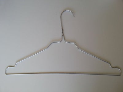

Ok, now you may have took your girl or your mum one of her hanger. She probably asked you what it was for since she obviously knows that it's not to hang your brand new shirt...

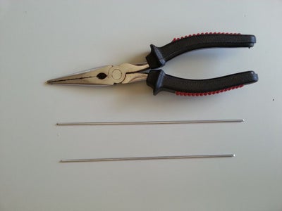

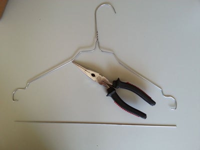

The hanger is to extract two little aluminium rod out of it. These are going to be the frame to support the webcams and to attach them to the gripper.
CAUTION : Please first make sure that the rod diameter is in the 1.5-2mm range ! Otherwise it's not going to work with the cameras rotating system...

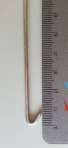

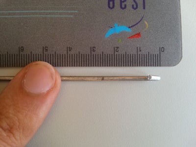

So take the hanger and cut on each side of the bottom part as shown in the second picture. This gives you an aluminium rod.
Next, cut the rod in approximately two equal parts. It should give you what's shown in the big picture.

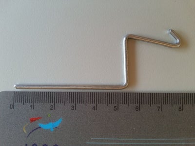

Step 2: Bending the Rods
Now you have to nice straight rods, you'll have to bend them to form the desired shape to support the webcams.

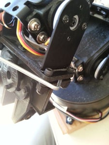

Start first by making a half buckle as shown on the picture.

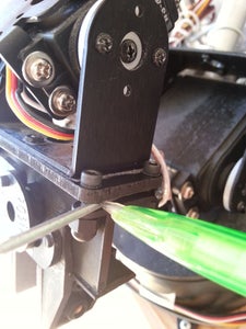

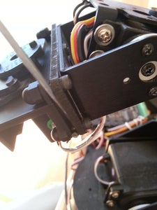

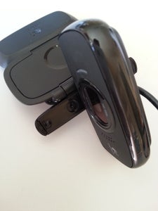

Now, you can have a preview of what you just did by presenting the bent rod to where it will be placed.

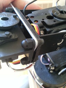

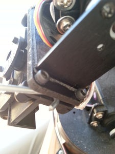

To do so, just unscrew the three (maybe four) screws of the grippers (the ones with black plastic nuts).
Just leave them unscrewed enough to allow the rod to fit as shown in the second picture.
If you did well, it must look like the third picture.
Once it's ok, make a mark on the rod where you'll have to make the second bend.
When doing so, you have to make sure the buckle is clearly well locked by the screw by slightly pulling up on the rod.

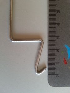

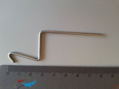

Step 3: Second Rod Bend
As an example, you can double check with the mark I drew while I was making it.

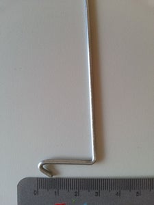

Now use the flat nose pliers to bend the rod another time as shown in the main picture.
As a hint, if you use the same marking as I did, you'll have to hide the mark with the pliers nose to have a correct bend.
I made the mark a little too low, so it did not fit quite well when put on the robot...
The best thing you could to is to use the main picture as a reference. This one is the final bend I had working perfectly.
It all has to be well done. Everything has to be planar and with good bend angles, which is easier to say than to do...
Note that the angle between the rod tail and the ruler is not 90°. That's to compensate the way we mount the rod on the robot arm.
In the end of this step, you should be able to mount the rod as shown i the last picture without forcing while doing so.

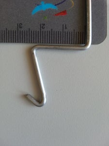

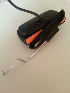

Step 4: Last Rod Bend
Almost done ! Now we'll bend another time the rod to give it it's final shape.
So, now bend the rod as shown in the pictures.
As for the other steps, you can try mounting the rod on the robot to see if it fits and make some corrections if it's not.

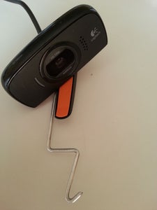

Step 5: Webcam Stand Hacking
Ok, now let's start with the nice part ! Hacking the webcams !

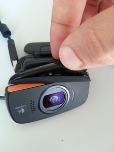

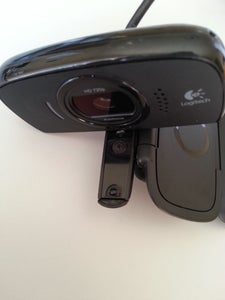

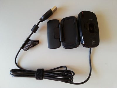

First, start unboxing the webcams ! Now you got it on hands, it might look like the picture above.

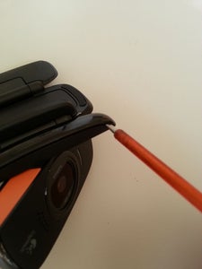

Step 6: Removing the Webcam Stand
At this step, you must not continue if you didn't read what on upper characters on the very first step : from this step, you are going to void the webcams warranty, so do it at your own risks, I'm not responsible for that. Thank you.

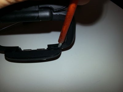

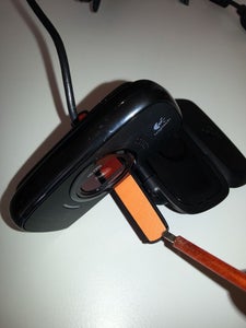

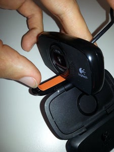

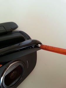

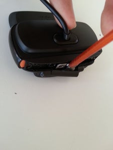

So well, see this orange  strip ? Well remove it by slipping your little flat head screwdriver in the small interval on the right or on the left of the strip. You may be able to obtain what's shown on the second picture.
At this step, be careful not to put your fingers on the strip bottom, the side with glue in it, because you want to put it back afterwards to have a clean fine don't ya ?
Using the same method, remove the second orange strip of the webcam.

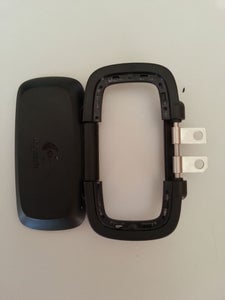

Step 7: Removing the Stand Cover

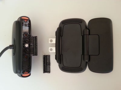

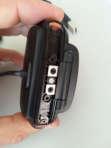

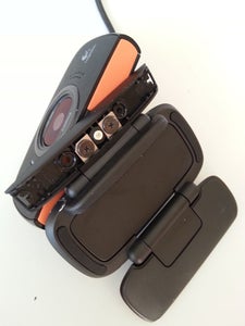

Now you removed the two orange strips, you should see two screws.
Unscrew both of them.
Then, using the flat head screwdriver, as shown in the image, remove the stand cover.
It may require a little force to do so because as you may have noticed, on each side of the screws, there's a molded plastic lock.
Don't worry, you'll still be able to screw it without a problem.
Now you did it, remove the second cover as shown in the last photo.

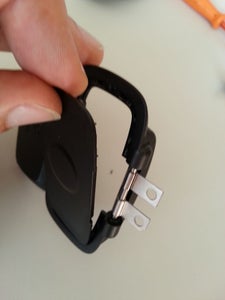

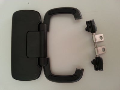

Step 8: Unmounting the Stand

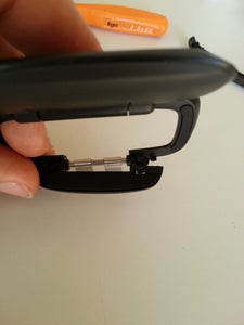

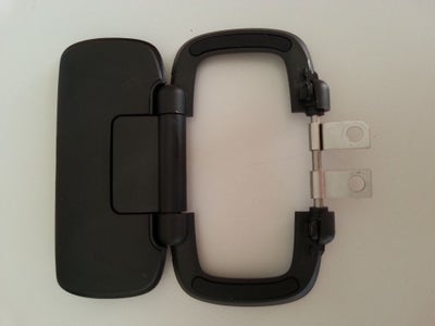

Remove the two screws. You can now remove the stand as shown.
Remove the two pieces of plastic which are in between the two branches.
Take a few seconds to give a look to the hinges. They are different and the have to be mounted on a special orientation so to work and fit on the webcam ! Please not this point in somewhere, so you'll mount it on the right side when it'll be time !
Step 9: Hacking the Stand

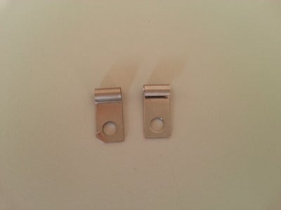

Now, we are about to hack sorry, modify the stand system to have it work with our own system.

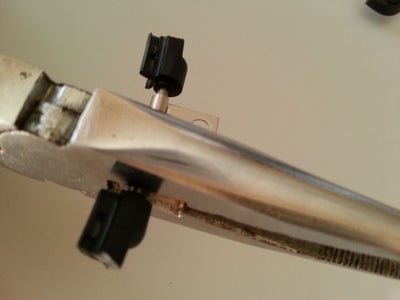

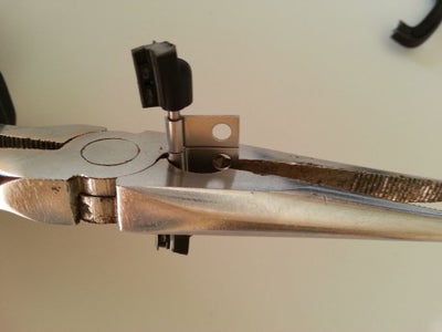

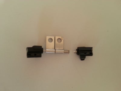

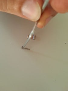

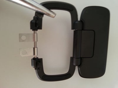

To do so, using the flat nose pliers break both stand branches as shown.
Try putting on one side the hinges.
Then, pick up your (strong) pliers (that's now it has to be very strong, and you too, "use theee... the fo... the fooorce Luke !!") and cut the rod as shown.
You may now be able to remove the hinges.

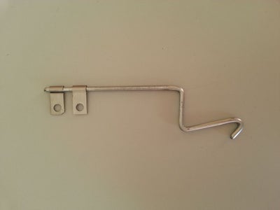

Step 10: Reusing the Hinges

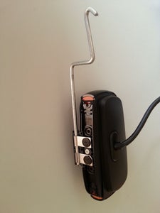

Take your hand made rods and put the hinge in it.
Take care of the side ! As I said before, hinges have a right side you should take care of to have your webcams installed perfectly and in the right side !
Once done, install the hand made hinge on the webcam and screw it.

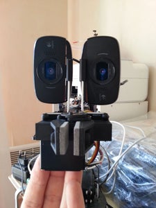

Step 12: Final Mounting
Ok, so here we are ! The final piece !

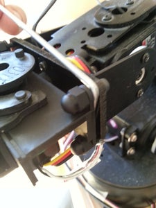

Mounting the webcams on the robot hand !
Now you can have a preview of what the webcams see with some software and adjust the positions and orientations to you requirements !
You also have to arrange and attach the cables on the robot frame to avoid knots and other issues.
