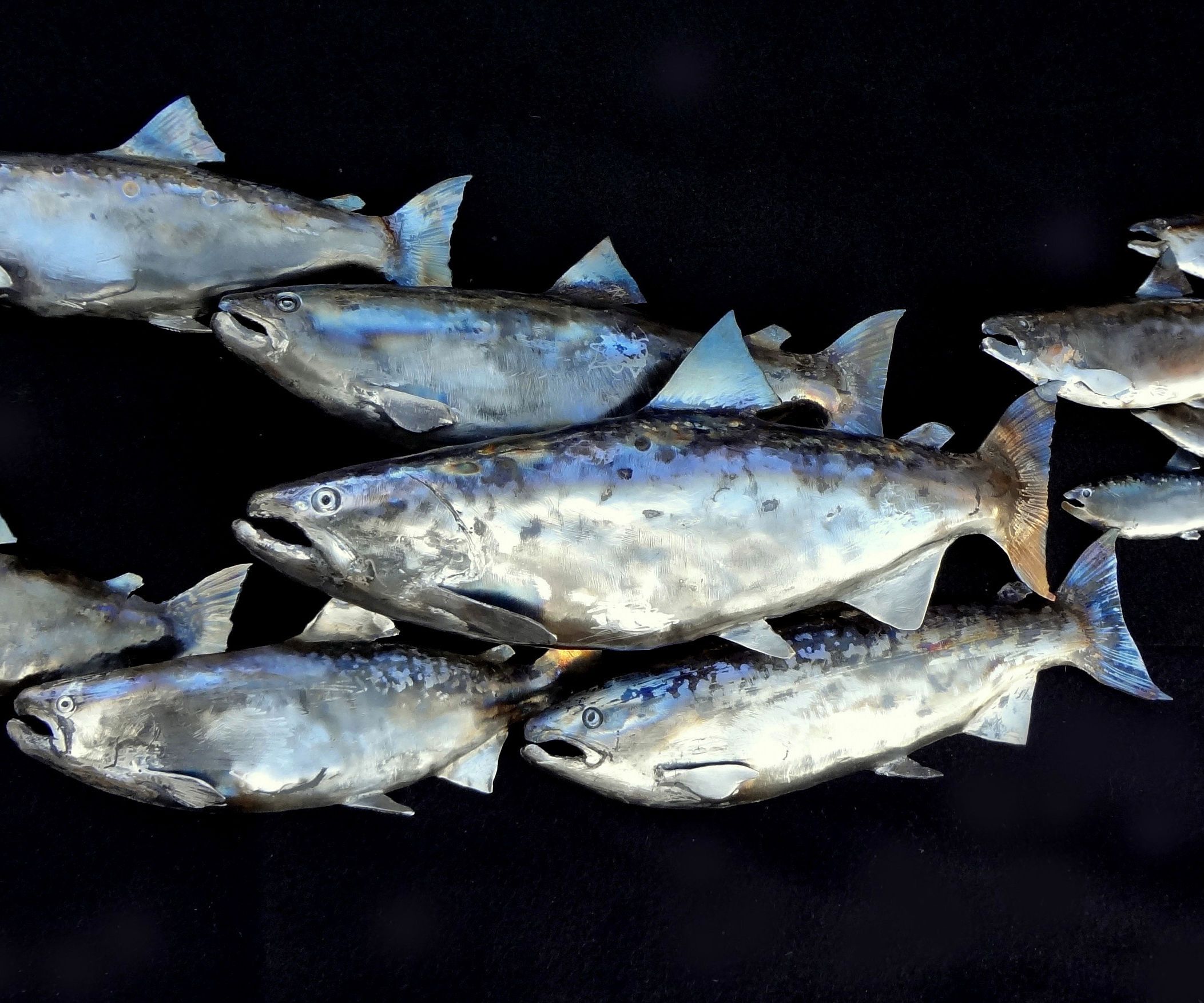

Step 5: Other Things With Welded Metal and String Art
Here's a video showing part of the process of making Glamour Girl.
Because you coat the foil with adhesive, you can do inside contours with belly shapes as well.
Go nuts with your own Welded metal and String Art!
