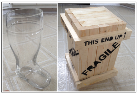

I'm ready for my next Instructable! Like many Americans, I like drinking beer out of a glass boot:
Unfortunately, I don't have a good way to store and protect my glass boot when not in use.
When thinking about the best way to store my glass boot, I kept thinking back to the scene in A Christmas Story when the leg lamp arrives:
I decided to build a scale model of the leg lamp box to store my glass boot. I think it turned out pretty nicely and now it looks like my boot is Italian. Here's how I did it...

To complete the look and provide some padding, I shredded some brown paper grocery store bags to pack around the glass boot. I'm pretty happy with how it turned out and it looks great on the shelf!
