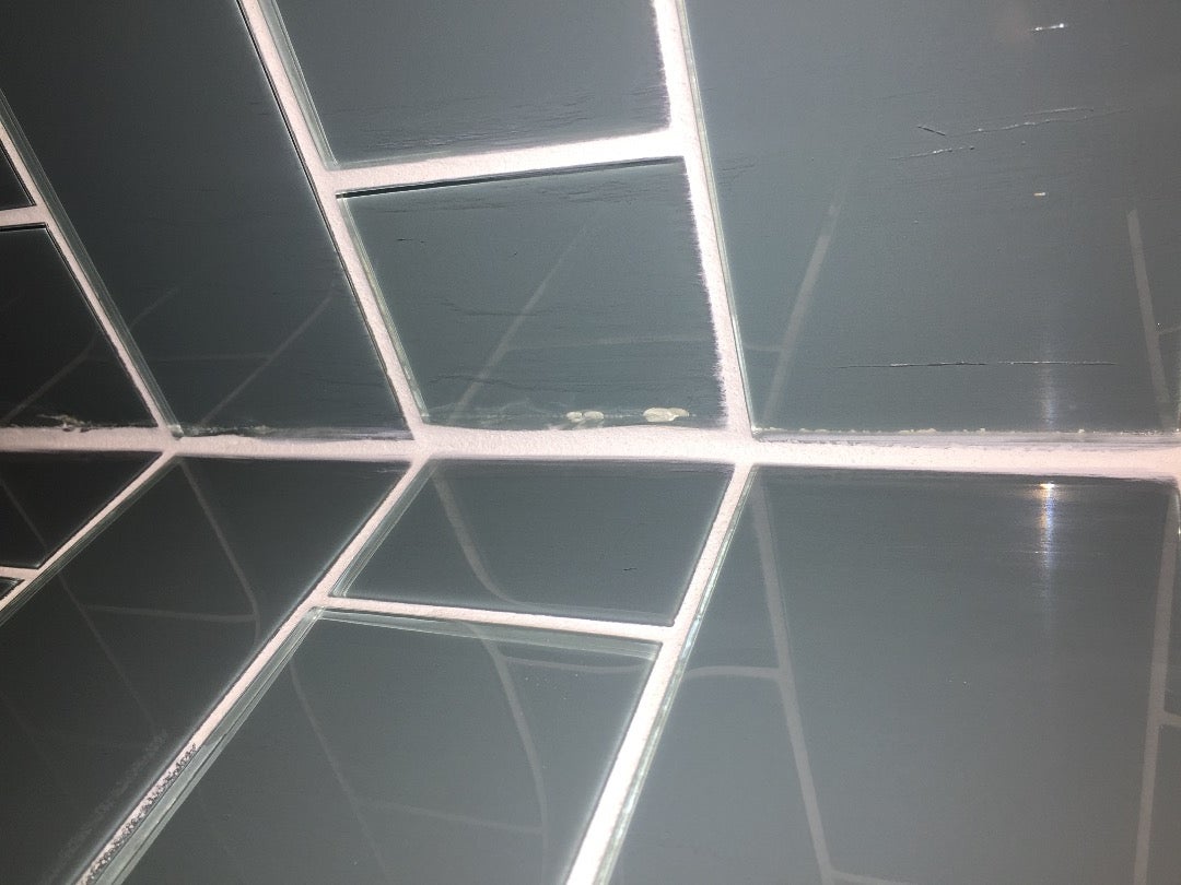

- When you cut glass tile with a wet saw or a score cutter the paint on the back can chip off. This is visible on the finished tile. I wish I would have done this as these blemishes are visible and don't look all the good.
