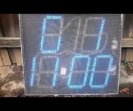

The Information Board described here receives Gliderscore serial data via a serial radio link (the serial link is described in another Instructable). It parses the serial data and displays it on a series of LEDs.
The Information Board will display the Glider Timer round and group either setting up or flying. To indicate whether it is preparation time or working time, the characters will be lit red for preparation time and green/blue for working time.
The receiver is an HC12 transceiver module working in the 433Mhz ISM band. It requires no programming in order to work in this application.
The computing is done by an Arduino. This project has been designed around the Arduino Pro Mini, but an Arduino Uno or Arduino Micro (or any Arduino with at least 8kB of memory can be used)
The LEDs are generally known as WS2811. One can buy these on line from a number of suppliers. They come in strip form containing the WS2811 driver chip and three RGB LED chips in a section. The sections are usually sold in a continuous strip from one to 5 metres in length.

Step 1: Backing Board
The backing board is easily made
Cut the 3mm sheet to 480mm x 340mm
Cut two lengths of the 19mm x 19mm timber to 480mm
Cut two lengths of the 19mm x 19mm timber to 302mm
Glue and nail the timber to the edge of the sheet. Use clamps to hold the timber whilst the glue dries
Paint the "inside' of the backing board with the matt black paint
Paint the outside of the backing board with gloss paint.
The prismatic acrylic sheet can be fitted after the electronics are tested
The sheet is fastened by the timber screws around the perimeter at intervals of 100mm
Drill 1.5mm pilot holes through the acrylic sheet and into the timber.
Drill a 3mm clearance hole in the acrylic sheet for the screw
Step 2: LED Strips
The general layout of the LED strips is shown in the file Small Layout
The LED strips are placed on the backing board and adhere via the sticky tape supplied on the strip
Apart from one characters that represent the number '1", the other two characters are laid out in the form of a seven segment display
A template for each seven segment character is supplied in file Digit Template
I print out three of these (make sure that you print without any scaling).
Cut out with a hobby blade the areas where the LED strips will go.
There are 7 places on each template to cut out - 100mm x 10mm per segment
Use the digit templates to layout the characters on the backing board. Use masking tape to hold the templates temporarily
Cut the (long) LED strip into sections of two sections long. Each segment is 100mm long.
The LED segments will eventually make one long electrically continuous line. Use the diagram in drawing ZZZ as a guide .
The starting LED segment is A and is followed by B, then C etc.
The LED segments have an arrow denoting the direction. Make sure that all segments have the arrows pointing in the direction of the end of the string.
Take off the adhesive backing paper and glue the segments on the backing board.
Use short lengths of the copper wire to join the 12V, D0-DI and GND pads of segments at the corners.
Use lengths of insulated wire to connect DO-DI between characters.
Drill the back of the backing board to accept the 2.5mm DC socket. Wire from the back of the socket the GND wire to each character and the 12V (positive) wire to each character. This is to make sure that the voltage drop is minimised to each character

Initial testing of the electronics
To program the Arduino Pro Mini, you will need to use an USB to serial converter. Connect the Arduino Pro Mini through the USB to serial converter to the USB port of your computer
Test that you can download the blink sketch to the Arduino. If this is not possible trouble shoot the problem
(This Instructable is about the construction of the Timing Board. Any issues with the Arduino are able to be researched on line by reference to the Arduino site or to doing a search on line)
Attach the completed electronics to segment A of the backing board Its only three wires being 12V, GND and DI
Testing of the LEDs
Install the Adafruit Neopixel library
Open the example sketch called Strandtest
Change the LED count to 16 and the LED PIN to 2 (for an Arduino Pro Mini)
Download and run the sketch. At some stage all the LEDs should light.
If the LEDs light partially along the string, then either the power or the data connection is not continuous. It could also be caused by faulty WS2811 chips. In case of a faulty chip, it's easier to replace that section of LED strip and retest.
Once you are satisfied that all the LEDs are operating correctly, you can install the Information Board program onto the Arduino.
