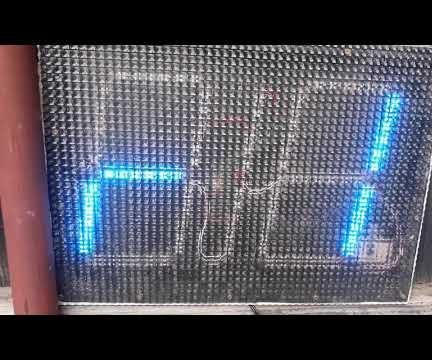

Introduction: Gliderscore Transmitter
Gliderscore is a program developed by Gerry Carter that not only scores a model plane flying competition, but provides timing for the various flying tasks
One feature of Gliderscore Timer is that it outputs a Serial ASCII string that contains the countdown time, the group , the round and whether it is working time or preparation time.
The above description really is only for the benefit of those who use this program
The Transmitter described in this Instructable is used to interface between a computer USB port running Gliderscore and Timing or Information Boards described in other Instructables.
I hope people can use my ideas for other projects.
The transmitter is an HC12 transceiver module working in the 433Mhz ISM band. It requires no programming in order to work in this application.
