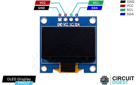

Step 1: Schematic Diagram
The electrical diagram is extremely simple and does not require additional explanations. The two LEDs are optional. They may be missing.
Connect the SDA pin of the display to the GPIO19 pin and the SCL pin to the GPIO23 pin. The power supply pin is connected to 3 volts.
