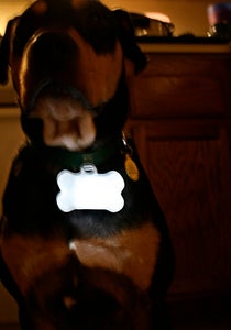

Make you dog light up during your night-time walks! Still on an LED high (and still have a lot of LED stuff left over from my first project), I decided that it would be helpful to make some sort of light doohickey that I can attach to my dog's collar when I walk him at night. His black fur has a nice sheen, but it sure makes it difficult to see where he is and *what* he's chewing on at night (ewww) at the not-so-well-lit dog park near my house.
The end result is a nifty mod resin clip that shines a semi-diffused LED light operated on 2 AA batteries through a switch. I used a silicone mold and clear resin to make the body (it was my first time casting!). Of course, a lot of these steps can be modified to personal preference. But the most important thing is: make sure that the simple circuit is safe and secured, and that the resin body + battery case is not too heavy! You might need to adjust what battery source and circuit you will need based on the size of your pet. Cisco (pictured below) is 90+ pounds.

Switch it on and let your hound shine in the night!
Instead of just any clamp-style clip, I opted to use an old nerdy convention nametag holder (okay, okay, fine, it was from Blizzcon 2005). With this kind of nametag clip, I can clip the Glow Bone onto the collar AND I can also use the snap tag and have it hang from the collar.
Glue down the clip onto the battery case. I thread the snap tag through the little handle so it wouldn't lean or tilt forward.
Step 5: TEH AFTERMATH!
Here are some notes from using the Glow Bone for the past 4 days:
-Cisco seems oblivious to it when I put it on but he thinks it's magic when I switch the light on.
-I can see where he is clearly when I'm 10 meters away from him at night in the dog park.
-Other dogs like sniffing it.
-When CIsco sprints, the Glow Bone does bounce off his chest. In fear that one day he's going to run so fast that the Glow Bone bounces off his chest so much that it hits his lower jaw, I started clipping the bone onto his collar rather than hanging it using the snap tag.
-Cisco has no interest in eating the Glow Bone
-He now knows that when it's being clipped onto his collar, it means that he's going to the park, so he gets really excited.
