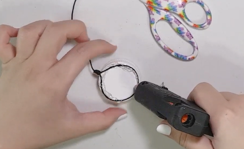

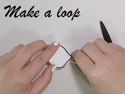

  1. Use a string (fish line) to make a loop base on the fish size. I used a circular cap to make a loop easier.
  2. Then use the straw to make a knot. Take the longer end of the string to wrap around the shorter end and the straw at the same time a few times toward the loop, then put the long end through the straw, pull the straw out, adjust the ring size and make a tight knot.
  3. using the scissors to cut and the lighter to seal the short end of the string.

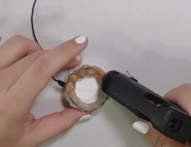

  1. Use the hot glue to glue the loop to the cap, this step is to create a surface so that the stones can have some base to stick on later.
  2. Glue more hot glue to the loop and adjust the thickness of the loop base on the size of the stones.

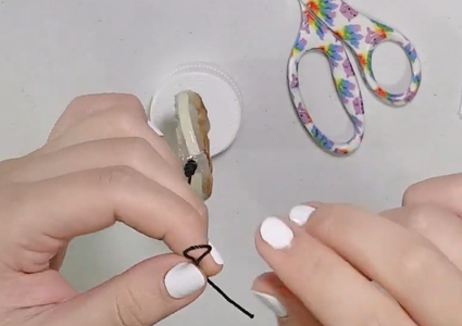

  3. Glue stones on the loop.

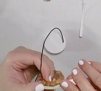

  4. Be careful taking the loop off from the circular cap. ( you can use a knife to make it get off easier)
  5. Now glue stones to another side of the loop.
  6. Glue the inner and outer loop, to seal the string which makes the loop. Make sure when you glue, the surfaces need to be smooth.

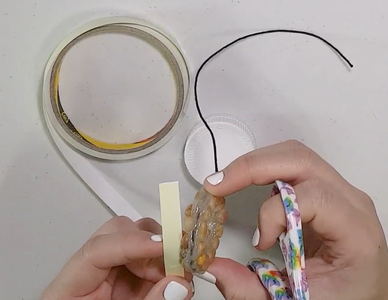

  1. Adjust the length and the width of the luminous glow tape, then stick it around the ring.
  2. Then use hot glue to make a thin layer to cover the luminous glow tape, make sure to completely seal the tape, and create a smooth surface as well.
  3. Use a knife to take off the excess glue, to make sure the ring is smooth so that it does not hurt your fish fins and tail.
