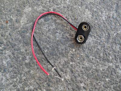

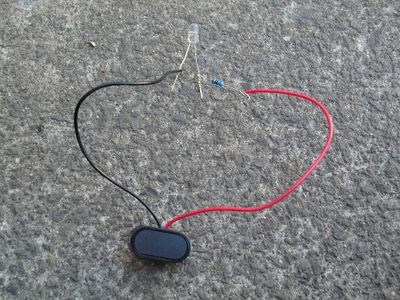

Step 1: Assemble the Circuit

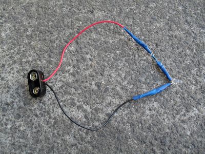

Connect the circuit shown in the photo.
The longer terminal of the LED, the anode is connected to the resistor, the positive terminal side. The shorter terminal, the cathode is connected to negative terminal of the battery.

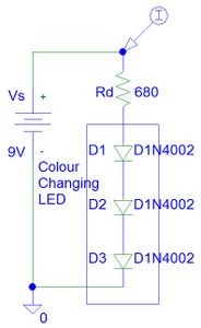

In the PSpice software circuit drawing shown the three diodes are used to model one LED. This software does not have a LED component drawing in it. Thus diodes are used instead.

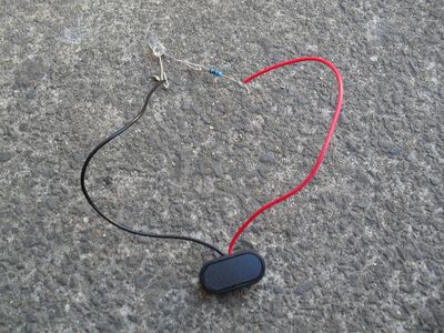

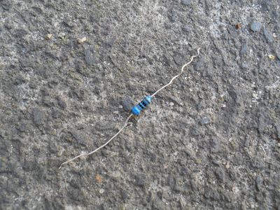

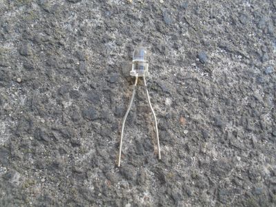

Step 2: Bend the LED Legs
Bend the legs of the LED to make stronger connection that cannot be pulled apart easily. Note that one of 680 ohm resistor terminals where already bend in the previous photo.
Step 3: Apply Insulation Tape
Cover the terminals with electrical insulation tape to prevent short circuits.

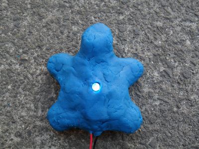

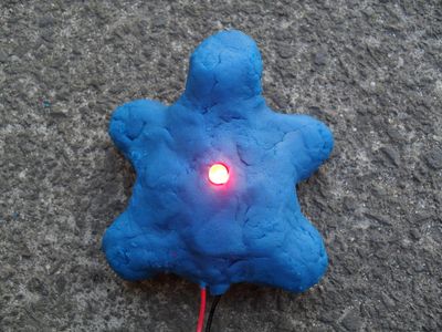

Step 4: Make the Glow Worm From Plasticine
Make the glow worm from plasticine, insert the circuit and you are done.

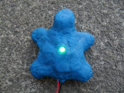

In the other photos you can see the glow worm LED changing colour from red to green and then to blue before repeating the cycle.
