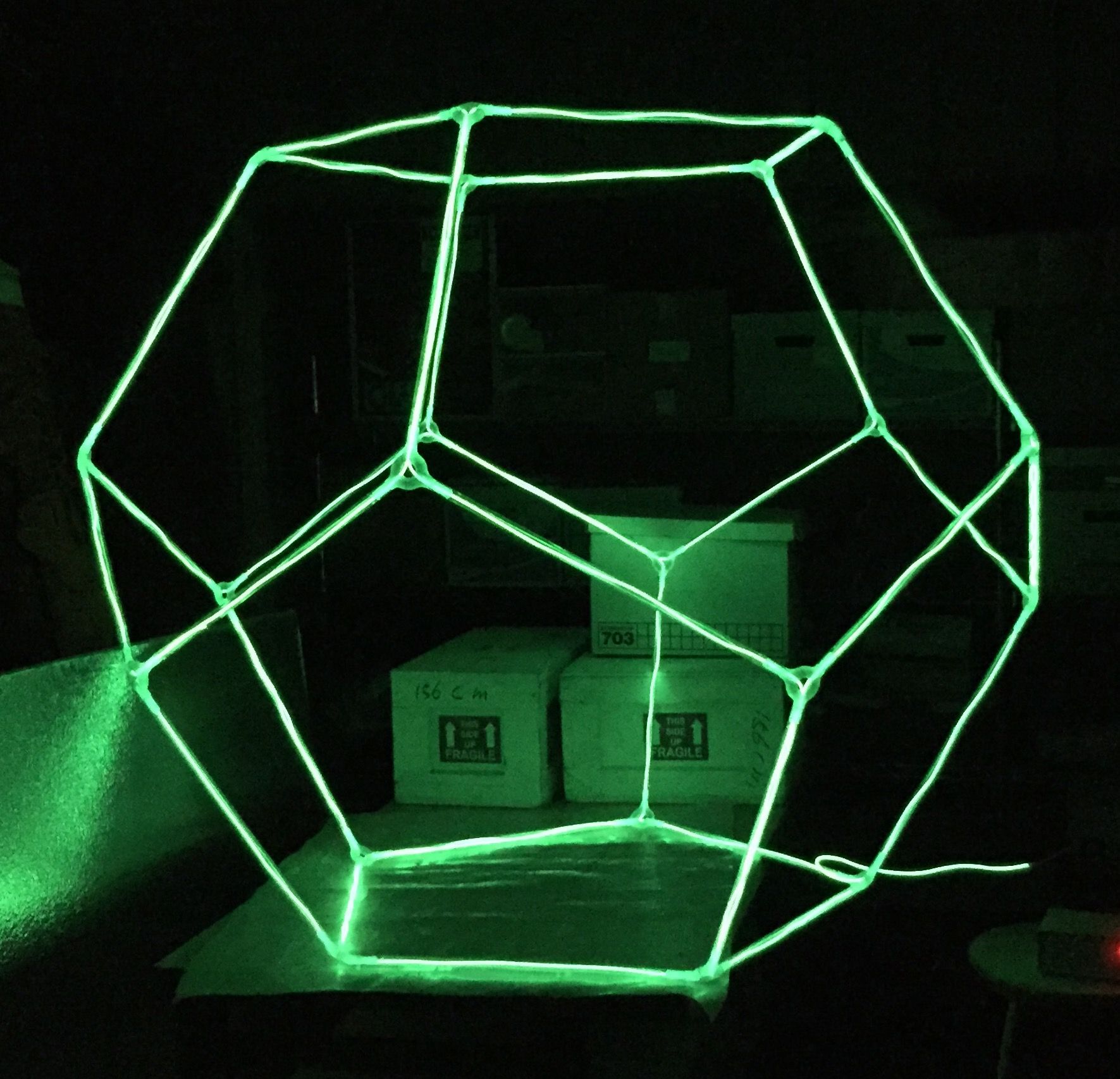

Trim the thermoformed plastic into circles and tape the tubes in place.
Step 7: Assemble the Sculpture
I threaded a single strand of EL wire through the entire structure before riveting the joints together. The tubes are large enough to allow two strands of EL wire to be threaded through.
Eye-bolts were added to some of the joints so as to suspend the sculpture from the stand using cables. The cable suspension allows the sculpture to hang in the air and gently twist in the wind.
