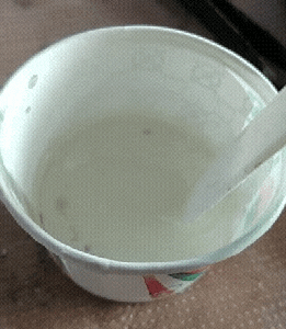

Circle the base edges with masking tape and in centre too.
Here i have used 2:1 resin & Hardener ratio, so for first layer of pouring mixed 40 gm of resin with 20gm of hardener. After combining well, the resin should be transparent like see through. Kept it ideal for 10 minutes so i get pouring consistency like honey.
Transfer the metal butterfly on the acrylic surface and peel off the plastic sheet
Why to do like that, why can't it be poured directly after mixing?
Here's why
1) Need the epoxy resin in honey consistency,
2) Fixing/covering the flowers with epoxy resin as first layer, if when poured with water consistency the flowers tend to move and get dispositioned
3) Also dried flower has the tendency to float above resin as its light-weighted

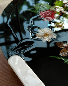

Step 4: Second Layering
After 24 hr when the first layer is cured, mix up resin of resin-60gm & Hardener-30gm to obtain 90 gm and start pouring the thin layer. Using resin spatula drag resin and cover up the spots till the edge
Step 5: After Second Layering
After few treading mins of drag resin carefully avoiding drip (even though its covered with masking tape), final look will be like above.

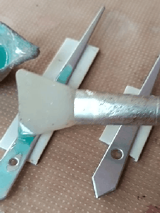

Step 6: Glow in Dark Needles
Ok, so the numbering are in glow in dark, but without needle being visible how someone can check the time durign night time without switching on light, so needles especially hour and minute needle to be top coated with glow in dark portion. As mentioned above mix resin and add glow in dark powder and position it by sticking onto double tap to avoid base movement. Using silicone brush apply coating even the numbers taken out of mould, just to give a convex finishing
