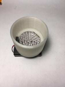

Step 1: 3D Print the Enclosure and Laser-cut Acrylic LED Cover
To make a pressure-sensitive enclosure that switches on the light whenever you set the ball inside of it, you'll need to download and 3D print the attached enclosure. It took about 3.5 hours on my printer. I printed with supports just for the channel on the bottom to run wires up inside, but it actually should be fine without. 25-30% infill is sufficient, low-resolution layer height is fine too. Of course, I used glow-in-the-dark PLA, but whatever color you have is fine.
The rectangular socket for the microswitch should work for a variety of them - the hole for the UV LED assembly might need to be tweaked depending on yours, measure things up and modify before printing. If you are using the exact flashlight specified here, things should all fit pretty well if your printer is well-calibrated.
I had a laser-cut clear acrylic disc leftover from this project, so just used that. It's just one vector cut on a laser-cutter, no engraving, and the circle should be between 65-67mm in diameter. I'm not uploading a .dxf file because I don't have one and mocked this up in about 5 minutes - it is quick to do in most proprietary laser-cutter software interfaces, and the cut will take less than a minute. 1/8" (3mm) plastic is fine, if you have 1/4" (6mm) that will work as well, use what you have but it needs to be clear. If you have a glass lens about this diameter use that.
If you can't get access to a laser cutter, keep the lens from the flashlight and glue a small strip of plastic or wood to push down the button of switch, as shown later. It's not quite as useful, but will work in a pinch. Share in the comments if you can think of an alternative method, I like to use laser cutters and 3D printers but recognize not everyone has access to one or both!

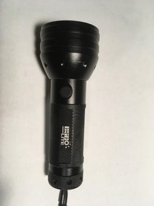

Step 2: Take Apart the Flashlight
Okay, time to disassemble your suspiciously cheap UV flashlight. SAFETY WARNING: I take no responsibility if you shine this device or the flashlight in your eyes and burn out your retinas or something. It does emit UV light that is marginally harmful if you stare at it for long durations, we're removing the filter but only turning on the device when the light is obstructed by the ball. Use common sense.

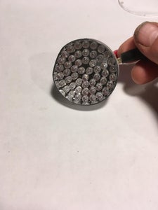

The light I had was broken, so instead of throwing it away I decided to use it for this project. This means I got to spend a bit of time exploring how these work - they are relatively straightforward, and I would suspect a lot of other similar UV flashlights of this price point on the market are exactly the same or similar. Thread off the front of the light with the lens cover. Take out the UV LED assembly. Throw the rest away or use for something else creative.

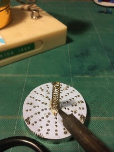

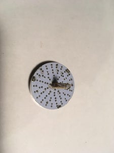

There will be a spring on the back of the LED assembly - you'll want to desolder this from the light, just touch your solder iron to it for a few seconds and pull off. The spring is the positive (+) terminal for the assembly, which goes to the battery pack. There are some larger solder joints at the very edge of the assembly - these are all the negative (-) terminals, and just contact the frame of the flashlight. You'll want to solder on a wire to one of the large negative solder joints, about 1" (25mm) long. Strip the other end, make a hook, and tin that hook with solder for later.

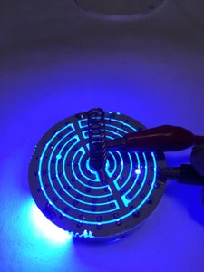

To test for functionality as shown, connect your battery pack with the red/positive lead touching the center where the spring was and the negative to one of those edge joints - it looks really cool from the back when you turn off the lights!

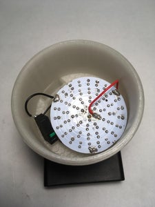

Step 3: Wire in the Microswitch
Take a look at your microswitch. It should have three little terminals on the bottom, and a little spring lever arm at the top. Remove the spring at the top - I just used my flush cutters, some diagonal cutters should be fine. There should be some letters on the switch that say "NO", "NC" and "C (or COM)". These stand for Normally Open, Normally Closed, and Common. How these switches work is two different ways - in Normally Open, the switch is open all the time except for when pressed, which then turns on whatever it's connecting to power. In Normally Closed, the opposite is true - whenever the button is depressed, the switch turns off connection to power and the rest of the time the circuit is active. C or COM is for the Common terminal, which is generally where the power or load is connected. The button on the switch connects between C/COM and either NO or NC.
We need to use Normally Open (NO) and Common (C). If you wire it any other way it won't work, so be mindful of this! I connected the black (ground or negative) wire from the battery supply up through the hole in the bottom below the rectangular recess to the NO terminal. Pull it through the hole, make a hook with the exposed wire, and tin this connection. This is good practice when working in small enclosures like this, it will make it much easier to solder this connection, promise. I had to cut the wire from the battery pack back a bit, and used the extra length in the previous step to wire to the light for the connection to the negative terminal.
Step 4: Wire in the UV LED Assembly and Test
Now we will add the UV LED assembly. Solder the little short black wire from the negative (-) solder terminal on the light that you have already soldered onto the UV assembly to the "C" or "COM" terminal of the switch. If you made a tinned hook, you can put it through the little hole in the terminals and touch with your iron, then add a bit more solder. This will make the connection both mechanical and electrical, and also makes it easier to work on in this tight space. Be careful not to touch your iron to the sides of the plastic as we fill it with these two items, it gets crowded in there fast and PLA melts fast.
Once you've wired the negative to the switch, take the red positive (+) wire that was fished through the center hole of the enclosure and solder it to the center of the UV LED assembly where the spring was removed.

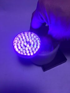

Now, it is time to test your circuit - don't skip this part! It is ALWAYS good practice to test before closing up. Put your batteries in your power pack, turn on the switch on your power pack if there is one, and depress the button on the top of the microswitch. If the lights turn on, you are good to proceed. If not, check your solder connections and wiring. I accidentally wired the light to the NC terminal instead of common, but caught the error in testing before putting everything in place semi-permanently. It happens to the best of us!
Step 5: Finish Assembly and Test Pressure Switch
Push the microswitch into the recessed area for it. Now for what might be the tricky part in replicating this - I designed the enclosure so that the microswitch is slightly above the ridge that goes around the perimeter of the inside of the enclosure. If yours is shorter, and hangs below, it will not activate when the ball is placed inside. Add hot glue, foam, or whatever is handy to build it up so that the little button is above the ridge and the acrylic disc will rest on the button.
Then push the LED assembly into its home at the bottom of the enclosure. If this fits snugly, sand the edges a bit or heat the enclosure in that area slightly with a heat gun/hair dryer and press in. It's good to test along the way to make sure you don't rip any of the wires out when you assemble.

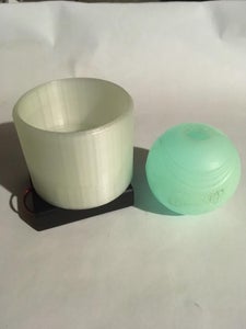

Put the acrylic disc inside the enclosure. Gently press on the disc - if all goes right, the microswitch button will be depressed and the UV LEDS will light up. Glue or tape the enclosure to the battery pack to make things all compact and tidy.
Step 6: Go Play in the Dark!
You and your dog are ready to have some fun! It only takes 5-10 seconds to get a good glow on the ball, and it lasts about 10-15 minutes. Once the glow starts to fade, simply place it in the device for another few seconds and repeat. I hope you and your dog enjoy hours of fun!
