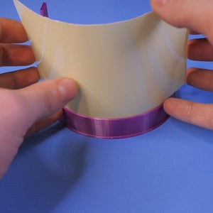

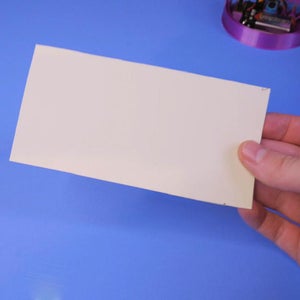

Step 4: Glow in the Dark Screen
The screen that the light will project onto is this glow in the dark sheet is like a big sticker and very sticky so I carefully stuck it onto the clear plastic sheet and cut it out. Dimensions: 150mm x 75mm

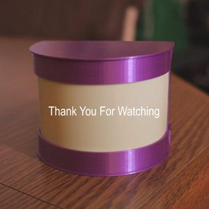

Step 5: Light It Up!
The build is complete and you can load the the code I attached and watch the light draw out the time. It's mesmerizing to watch and I am very happy this all came together and works! Thank you so much for watching the video and follow me at YouTube - 3DSage for more fun projects!
