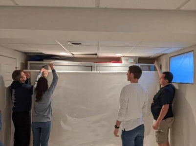

Step 2: Mount on PVC and Ceiling
Tape sheets onto PVC and attach PVC to drop ceiling braces
Step 3: Enclose Area for Darkness
Clip blankets to ceiling tiles to create a dark room for wall
