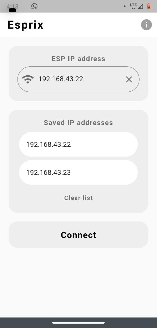

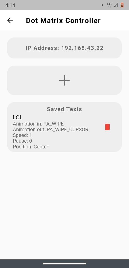

Step 5: App to Display
I made this app using Flutter to control the Dot matrix via Wifi.
App Features:
- Multiple IP Address Storage: Esprix empowers users to effortlessly store and manage multiple IP addresses, making it easy to control a variety of displays from a single interface.
- Versatile Text and Settings Storage: With Esprix, you can conveniently store multiple texts along with their customizable settings. This feature provides flexibility in displaying various messages on the connected display, tailored to your preferences.
- Fast and Responsive: Experience the speed and responsiveness of Esprix as it enables smooth and instantaneous control of your display, ensuring a seamless user experience.
- Intuitive and Simple UI: Esprix boasts an intuitive and user-friendly interface, making it accessible to users of all levels of tech expertise. The app's straightforward design ensures hassle-free navigation and operation.
- Open Source: Esprix is an open-source project, welcoming contributions from the community to enhance its features and functionality. Visit our GitHub repository at https://github.com/yash-ch/esprix to contribute and collaborate.
- Ad-Free Experience: Enjoy uninterrupted usage with Esprix - the app is designed without any ads, ensuring a clean and distraction-free environment.
APK for android is attached.
