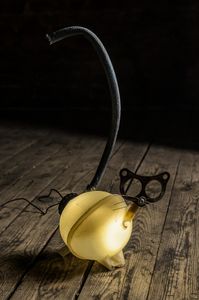

Introduction: "Glowing Cat" LED Nightlamp
This is a Instructable to create a nice looking, cheap and easy to do LED Nightlamp.
It has a wonderfuleffect, andcosts almost nothing.

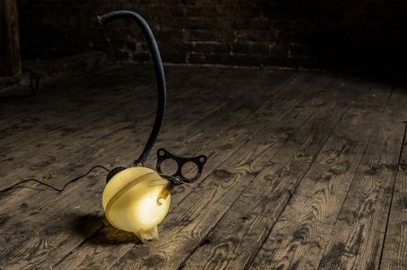

Step 7: Mounting the Light Unit
Now we will give the light to the cat.
The blackcolorshouldnowbe allowed to dry, otherwiseyou shouldwith thisstepwaituntilthecoloris dry.
You only need to screw the cap with our led instalation to it`s place on the Water Tank.
Step 8: Alright, That`s It
OK, thats it, now we can turn on the Lamp and enjoy the wonderful light.
Have fun while rebuild.
