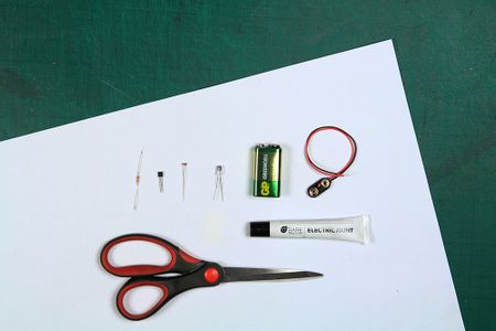

Step 1: To Begin You Will Need:
1 x Electric Paint Pen
1 x LED
1 x 100K Resistors
1 x LDR 202403
1 x Transistor BC548
1 x 9V Battery Clip
1 x 9V Battery
3 x Stickers
1 x scissors
1 x A3 paper

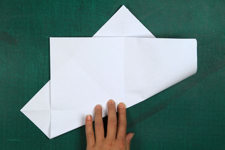

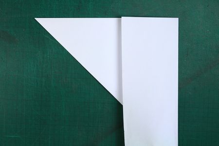

Step 2: Cut Your A3
Before we begin, you'll need to cut your sheet of A3 into two parts. We need a square piece to make our tree so you can fold one corner of the paper diagonally and cut off the excess so that you are left with two pieces as shown below.
Once you've cut it you should have a square and rectangular piece. We'll be using both pieces so don't throw them away!

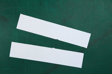

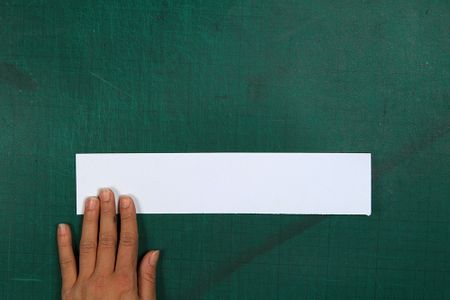

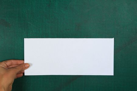

Step 3: Cut in Half
Take your rectangular sheet and cut it in half. You will only need to use one of the two so you can toss the other one.

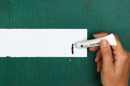

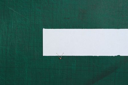

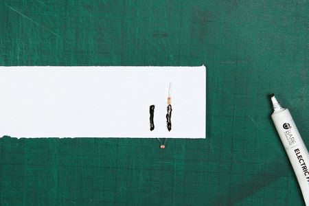

Step 4: Insert LDR
Measure 3cm from the edge of the rectangle, and then make two small holes near the top of the sheet.
Insert your LDR so that the two legs go through the holes and the head of the LDR peeks out above the paper.

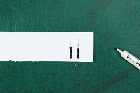

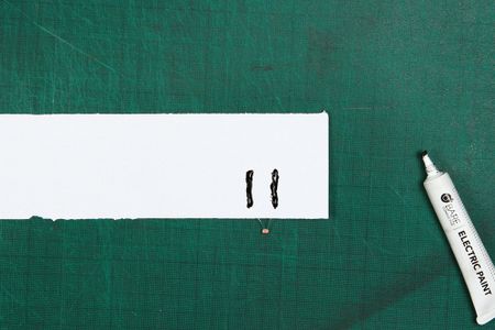

Step 5: Flip and Attach
Once your LDR is secure, flip your sheet over and using your Electric Paint pen, paint over the two legs of the LDR to secure.

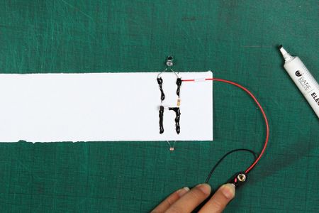

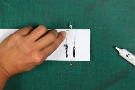

Step 6: Resistor, Transistor & LED
Next, place the resistor, transistor, and LED as shown in the images on the right.
We are replicating the circuit of the Glowing House Set but making it smaller so that it has a smaller footprint.

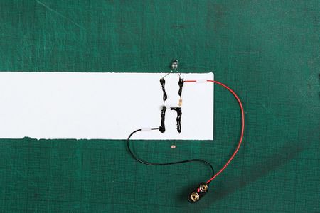

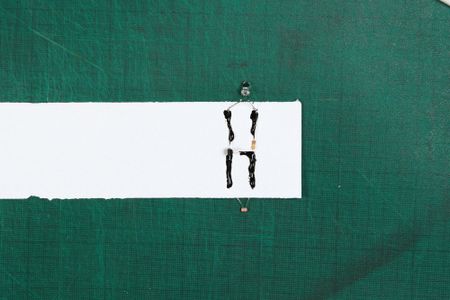

Step 7: Draw Your Circuit
Using your Electric Paint Pen, connect the components as shown below. Make sure to follow the image exactly so that your circuit works.
Step 8: Battery Clip
Next, you'll need to add the battery clip to your circuit.Cold solder the + (red) wire by the right leg of the LED.
Cold solder the - (black) wire by the left leg of your LDR.
You can use masking tape or small stickers to secure the wires in place.
Once your circuit is complete, put it aside to dry. This should take between 10-15 minutes.

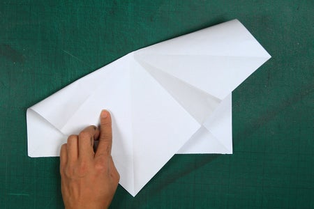

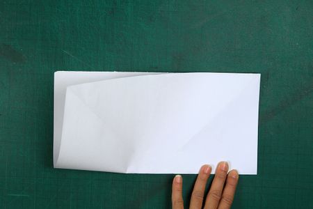

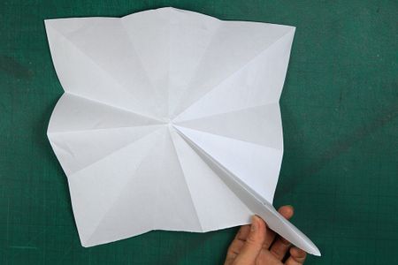

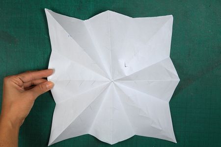

Step 10: Flip and Fold
Now, reverse your square so that your folds are now in the opposite direction.
You will fold your square four times again, however this time you are folding the spaces between the scores you made previously. Look at the two images on the right to see how to align your fold.
Do this four times so that your paper then looks like the third image below.

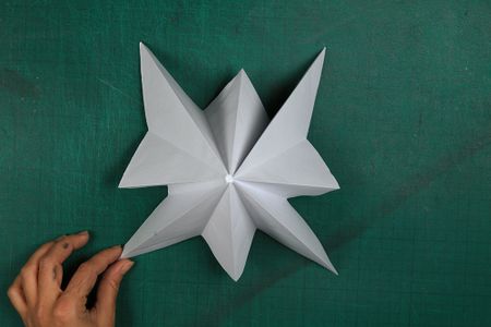

Step 11: Flip and Flold
Turn your square back around so that you can fold the four long corners of your square into a mountain fold as seen here.
Now flatten all the mountain folds so that your square becomes vertical. You should start to see the christmas tree shape emerge.

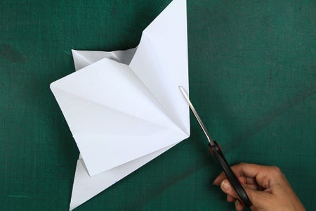

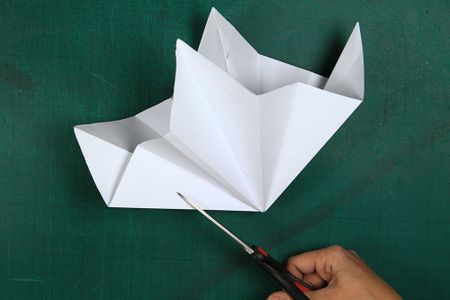

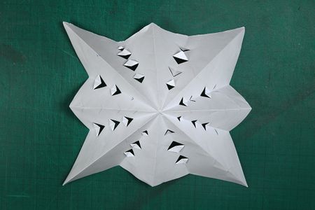

Step 12: Cut Slits
Next, making sure not to cut through several layers, cut 1cm long diagonal slits into each of the mountain folds.
You can do around three per fold as seen below.

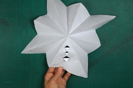

Step 13: Flip and Cut
Now flip your cone around so that he inner folds become mountain folds.
Repeat the step above, cutting 1cm diagonal slits into each side of the tree.
Make sure not to cut through to the previous cuts or you will lose the material!
Once finished, fold these tips downwards so you expose a triangular space within each cut as seen in the third image on the right.

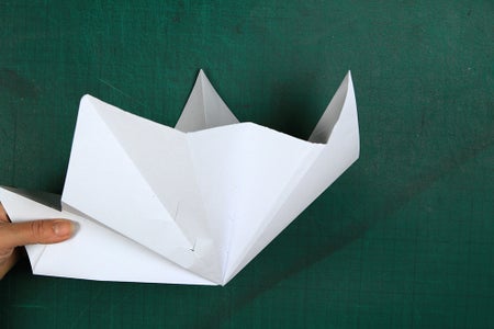

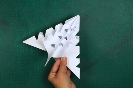

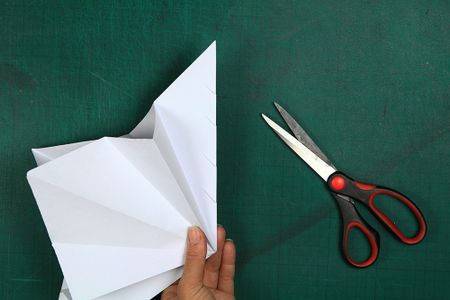

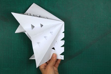

Step 14: Flip and Fold
Flip your cone around again so that your mountain folds with the holes are now valley folds.
Your longer corners should be mountain folds again.
Now you can take each of the slit you cut in Step 11 and fold them sideways as seen in the second image on the right.
Alternate each side for every other slit.

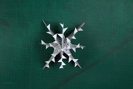

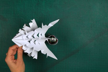

Step 15: Done Folding
When you're finished your tree should hold its shape and look like this when viewed from above!

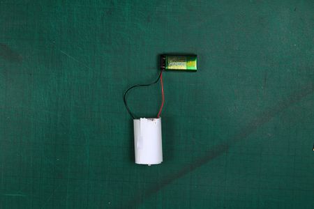

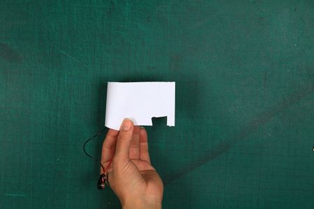

Step 16: Roll and Tape

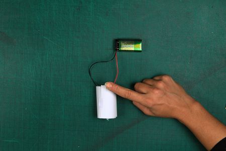

Go back to your paper circuit. Check if it has dry by gently tapping the paint. If dry it should no longer be tacky to the touch.
Roll your paper into a tube, and cut a small square where your LDR pops out from the side of the cylinder.
Use another piece of tape or sticker to hold the tube in place.

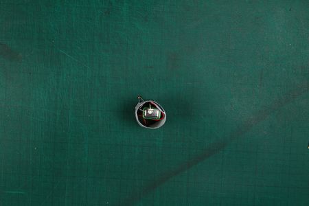

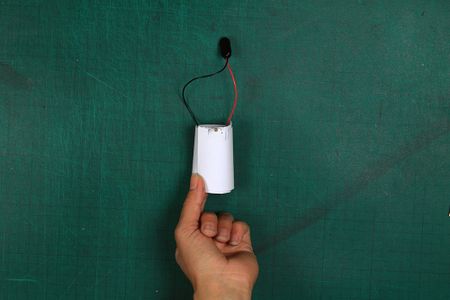

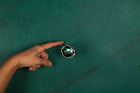

Step 17: Attach Battery
Now you can attach your 9V battery to the battery clip.
Once you've done this, check whether your circuit is working. You can do this by covering the LDR with your finger. LDR stands for Light Dependent Resistor.
This means it is a light sensor. In this circuit, when it gets dark the LED should light up.
Does it work? If not, go back and ensure your circuit is dry, and that you've attached all the components correctly as seen on Step 7.

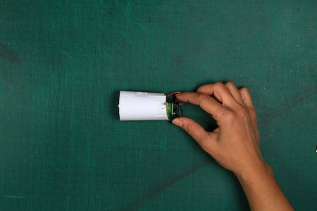

Step 18: Hide Battery
Insert your battery into the paper cylinder.
Step 19: Stand and Test
You can now stand your cylinder vertically. Check it still works by covering the LDR with your finger.
The LED should light up.

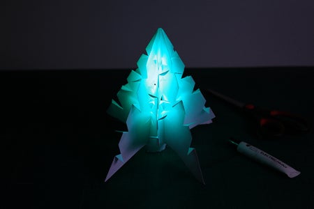

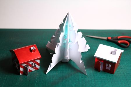

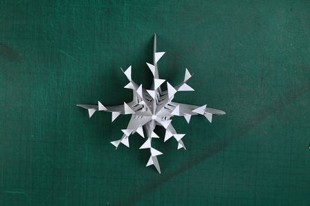

Step 20: Done!
Now for the finishing touch.
Cover your cylinder (trunk) with your christmas tree.

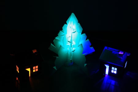

Step 21: Turn Off the Lights
Watch your tree glow! Turn down the lights and see your christmas tree come to life! If you still have one of your paper houses you can make a miniature christmas scene.
