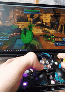

I've recently got my hands on an Arduino Pro Micro and instantly got the idea to create my own controller! So far I haven't seen any commercial product that features rgb lighting (we don't want to talk about their price ;) ). So I started building myself one and you can too! It's actually not that complex! I'd even say that this is a great first solder project for a weekend! Without further ado, let's get building!

With that you have everything set up. Now open up the control panel and go to `Devices and Printers` and perform a right click on your gamepad (In my case it was named `Arduino Leonardo`). Select the menu `Settings of game device` go to its `Properties` and `Test`. By pressing the buttons and rotating the joysticks, you should see these values change. However, there might be some issues with the joysticks, we'll fix that in the next step!

Great! Now you got yourself your own controller! Modify the code to your needs and enjoy some games. Stay creative and be sure to share! Keep in mind, that I'll revisit this project to create an improved version with all 16 buttons and maybe a display to select different controller schemes.
