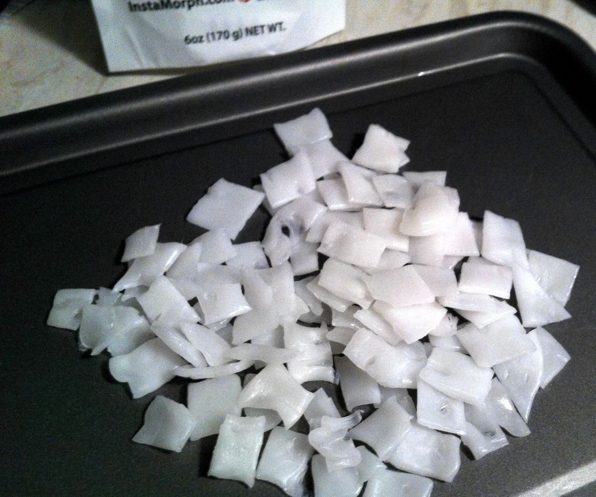

Step 3: Measure Out and Heat Your Instamorph
Measure out the volume of Instamorph you need by pouring the granules into your silicone mould. Due to its nature, you'll need to make sure the Instamorph granules are heaped into your mould. This gives the impression that you've measured out too much, but this is because once it has cooled again it'll be more compacted into your mould.
Heat the Instamorph following the pack instructions: Pour your Instamorph granules into 60 degree C water and wait until they turn see through.
