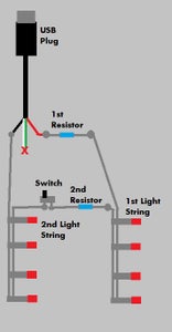

Step 3: Make Your Circuit
Build the circuit as shown in the diagram.
Join together everything apart from the USB connector (make sure the two strands of lights are the same way around otherwise it won't work) if you do not have resistors with your lights then these should be omitted from the diagram.
Plug your USB cable into the USB wall adapter and check polarity of the connections before joining to the LEDs
Make the final connections and test (ideally with the wall adapter)
Cover all connections with tape or heat-shrink tube.
