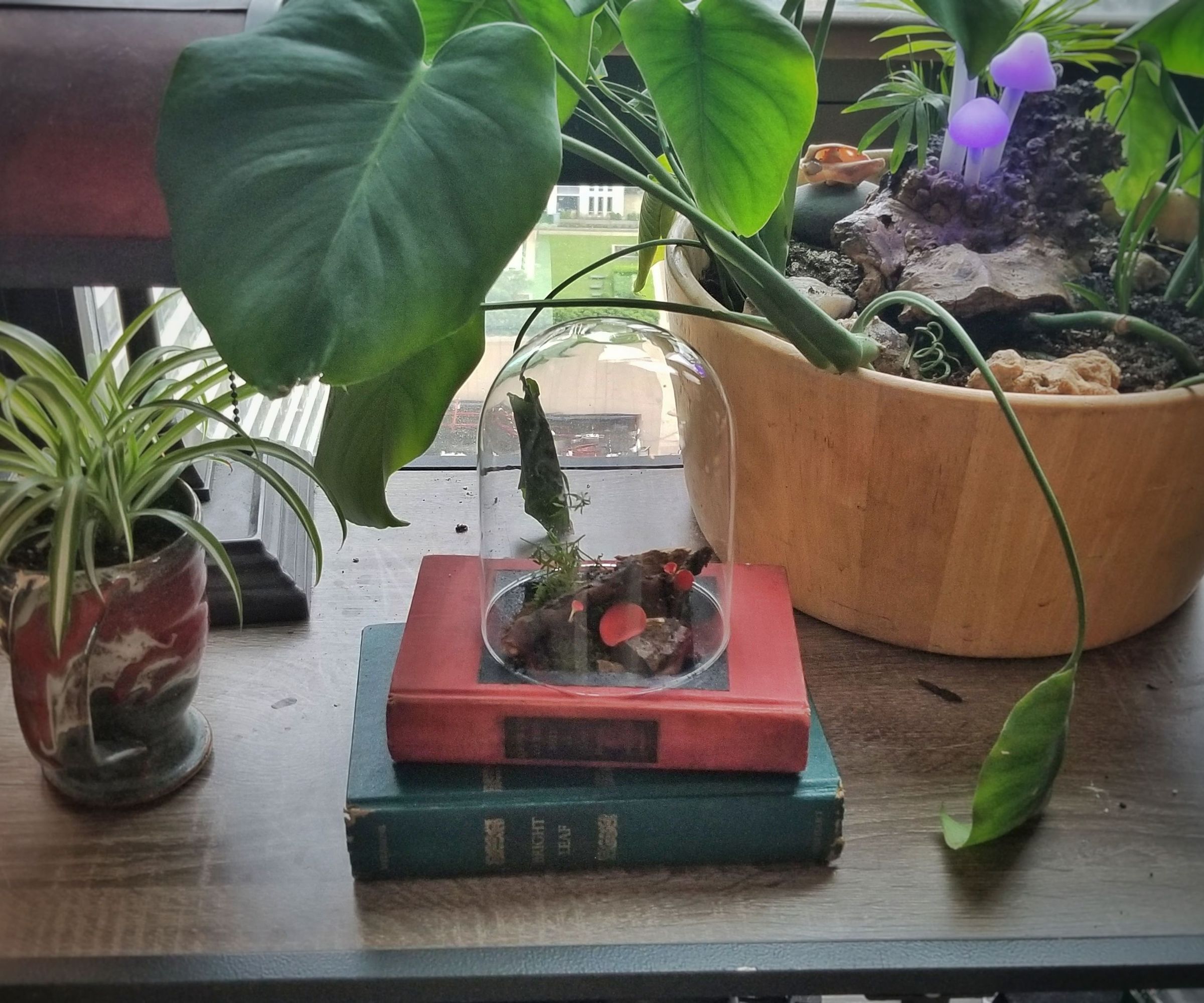

Show off your roboMushrooms to the world! This makes a great accent piece. Leave it on all the time, with a dim slow fade in pastel mode for ambiance, then crank it up to a fast bright mixed fade for parties! How versatile!
Happy making!
