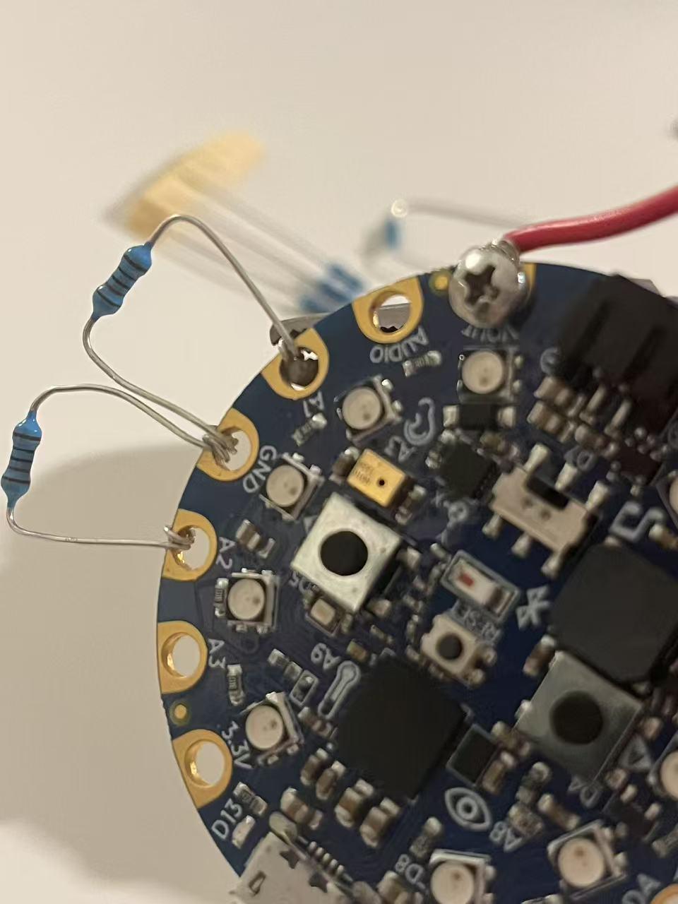

Attach the 6 force-resistive sensors on pads A1 through A6.

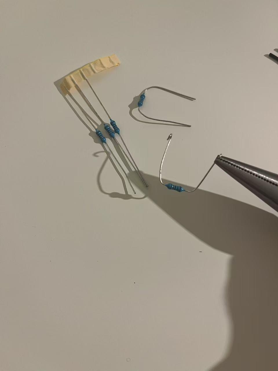

Note that force-resistive sensors produce analog input, which pad TX cannot accept.
  1. Attach one end of each of the 10k ohm resistors to A1 through A6, the other end to ground. You can solder it on the board, but I want to reclaim the board later for other purposes so I just used a plier to clamp it tightly on the pads.
  2. Make sure the wires don't touch each other. Wrap paper tape around to help.
  3. Use alligator clips to test each one to make sure the connection works.

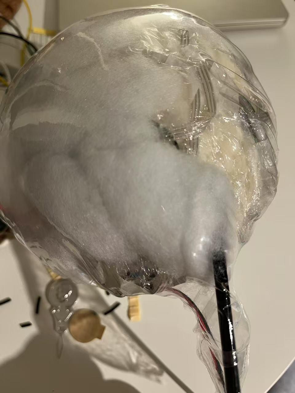

Step 3: Outer Shell
See this video for how to deal with the Bobo balloon.
Stretch, blow, release, cut open a balloon, and squeeze our ball into it.
Check that the circuit still works.

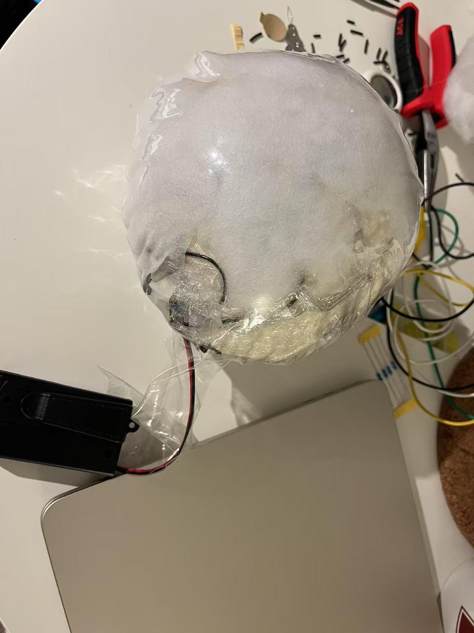

Seal the balloon, and stuff some polyester fillings. Repeatedly blow and release the balloon with air to make room for the polyester fillings.
Adjust parameters for force sensing in the code. The numerical range of input you will get when not squeezing and squeezing depends on the physical structure of the ball.
Unplug from the laptop and switch to a battery pack instead. Stuff some more polyester fillings.
Done!
