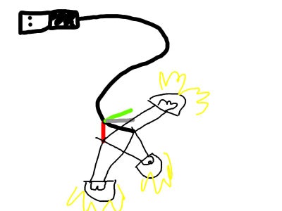

Step 3: Wire Up the LED/s
Take your cable, cut the end that isn't USB, the one that connected to your printer, camera, phone, etc
so you should be left with a cable with four wires on one end, and a USB end on the other.
find the red and black wires, they should be positive and negative wires, use the multimeter to double check.
Attach your LED/s either by soldering or wrapping the wires around each other. Remember to check polarity! If you have more than one, wire them up in parallel (for more information about parallel circuits, read this instructable)
Attach the LED/s to the corner/s of your board, making them face in, if there are more than one, put them on different corners, facing into the center on the side opposite to it.
