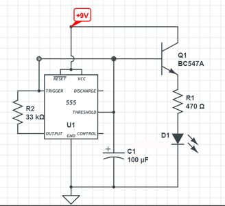

Step 2: Circuit Diagram
Here is the circuit diagram for the throbbing LED circuit.
For this instructable you will need a basic understanding of electronics.
I have used BC547 in the circuit. but i hav used 2n2222 instead cause i had them lying around. Just check the pin out for the transistors you use. The the transistor is used as a switch.
I have used 100uf cap. You can use another if you have any. I have tried it with 10uf. The pulsing speed of LED changes.
Changing the values of the resistors also changes the pulse speed. Experiment with different values befor you build the circuit.
