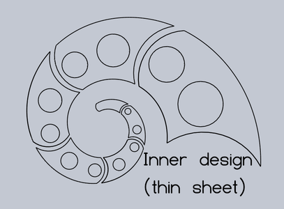

Create the design for your fossil. I used a Python program* that I created for making mathematically generated shapes, in addition to 3D modelling software. There are 2 parts for the design: The outline that will make the recess in the block of thick metal, and the design that will make the pieces of thin metal. You can also make several layers for the thin sheet and layer them to create a more interesting design!

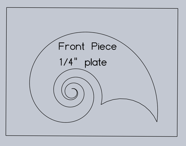

Add a rectangle to the outline part of your design- make it about 1 ½” bigger than the design on the top and sides, and 1” on the bottom. Save this drawing for CNC cutting (I saved as a DXF). This will become the top of 3 pieces that you will cut out of the ¼” steel.

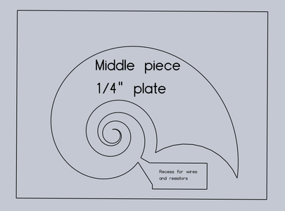

Now add a recess that connects to the design outline. This will house the resistors and wiring. Save this drawing, it will become the second of the 3 pieces of ¼” steel

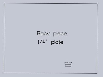

Add a small rectangle, just big enough to fit the USB connector through, to the side of the pocket that is furthest from the design outline. Now delete the design outline and pocket, and save this drawing- it will become the third piece of ¼” steel.

Prepare the 3 drawings you just made for CNC cutting in your CAM software,
and cut them out of the ¼” steel.
Prepare the inner part of the design for CNC cutting. It will involve lots of small pieces that can get lost easily, so I cut it twice to account for lost pieces. CNC cut it out.

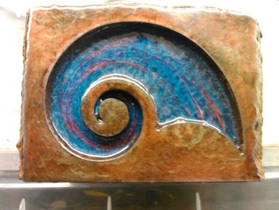

Mix up a batch of resin and add the pigment that you want for the top of the piece. I used a neat greenish/coppery pigment I found at a local art store. Pour a layer of this onto the top piece of steel(This should still be separate from the rest of the project) and set aside.
Make sure your wires and LEDs are where you want them to be. Mix up another batch of resin, this time coloring it with what you want for the back of the sculpture(I used iridescent blue). Pour a layer of it into the recess just deep enough to cover the wires.
Add resin until you are happy with the color of things and the diffusion of the LEDs. I ended up using one layer with deep blue pigmentation and a couple with less dense blue pigmentation. I also added some extra wires after the first layer, I wanted more "wiriness" in there.
When the resin on the top piece of steel has set and you are happy with the color, remove any stray resin from the back of it so it is clean and flat. Use E6000 to glue it onto the other half of the fossil, being careful to not get any stray E6000 anywhere visible. Make sure the top stays lined up as it sets, E6000 has a tendency to let things creep out of alignment if you're not careful.
Place the stainless steel pieces of the design in the recess. Fill the recess with clear resin, and overfill it a little so that you get one layer of resin over the whole top of the fossil. It may take a few coats to make the front flat.
Once everything is hardened, sand off any drops on the back of the fossil, and use a disc or belt sander to get the bottom smooth so that the fossil stands up. Plug in and enjoy!
