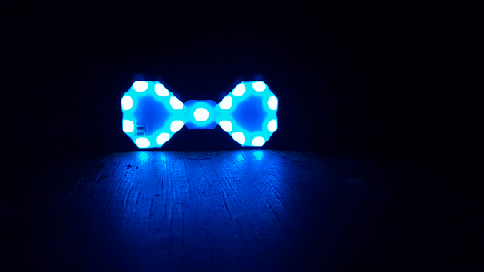

The Glowtie V2: more glow for less (bow)tie!
Ever since I built Raxathor's adaptation of the Glowtie, it became one of my favorite projects. My first version had a pretty solid base. It included a button, more effects and an improved webserver. Soon I decided to create a new, up-to-date version - Glowtie V2.
The new version should have a dedicated bluetooth app for controlling effects, react to music and have even more leds. It should also look way better than my last attempt. I had to start from the beginning again: designing a new pcb, soldering all the components and programming the MCU...

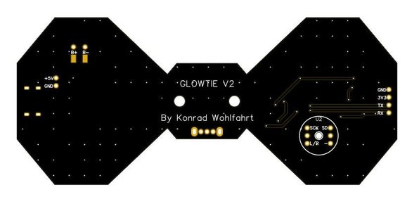

Instead of the ESP8266, the ESP32-C3 will be the heart of the new Glowtie. Its Bluetooth Low Energy and I2S communication will be perfect to expand upon the features! The LiPo Battery will be charged via USB-C by the common TP4056 charge IC. The MCP1826S-3302 LDO (or similar) will reduce the battery voltage to 3.3V and power the ESP as well as the I2S microphone. A few capacitors were added to reduce power spikes and a voltage divider reduces the battery voltage to a readable level for the ADC.
The new pcb turned out to be a little bit smaller than the last one eventhough it has four more leds.
With the gerber files generated, I ordered the pcbs from PCBWay. I received them a week later. They look awesome, especially with the black solder mask. I was satisfied with the quality and began to solder the components.
Note: During programming I discovered a major flaw! I connected one pin of the I2S microphone to a GPIO that cannot be used together with WiFi! Thus, I had to remove the audio visualizer from the WiFi version. Always make sure to read your MCU datasheets completely! I will probably upload a new gerber file without this issue, but you have to change the I2S pins in the code.

I ordered the pcb without silkscreen labels. This makes it a bit hard to find the exact place for the component. If your circuit board includes lables, you can just follow the table provided at my github repository, otherwise use the picture as reference. SMD components should be soldered first. Start from the inside and work your way outwards.
The unlabled components close to the leds are 100nF capacitors.

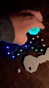

While soldering you should start your 3d printer or if you don't own one, order the parts together with the pcbs.
Depending on how you want to secure the pcb, I created two different enclosures. The first slides on the button of your shirt, while the other one can be used together with a ribbon and tightened around the neck. The pcb is secured to it via two M3 screws. Add the bumper on top for a cleaner look and further protection. For a more elegant look, place the diffuser on top of the bumper! Keep in mind that if you want to access the buttons, print `Diffuser Cutout` and the corresponding button raiser.
Unfortunately, the pins of the on/off switch can obstruct the button. You might want to trim them a little. Just make sure to avoid shorting the battery and disconnect it first!

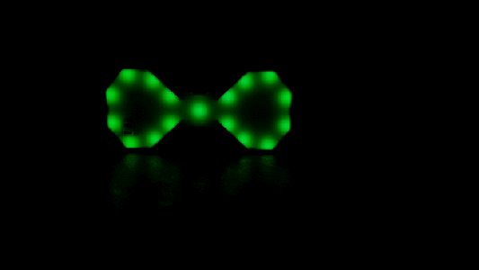

Do not plug in the FTDI programmer yet! First, press the upper button (Label - SW2), also known as Flash and connect the programmer to your pc. Do not let go of the button until the sketch started uploading! Select the corresponding port, board: `ESP32C3 Dev Module` and press upload. If everything worked, the sketch should be uploaded to the MCU and you can unplug the cables. If everything worked correctly, your Glowtie should light up.

  2. connect to your Glowtie via WiFi and open the website/ip (192.168.4.1) in your browser
  3. works on any device with WiFi and browser
BLE Version:
  1. has music reactive effects
  2. connect to your Glowtie via BLE with a dedicated App on your phone
  3. only works with the App
You might want to upload the WiFi version and adjust the mode, color and preferences. Press the save button (webserver) to permanently write the preferences to the EEPROM. Press and hold the upper button to save the mode and color to EEPROM. Now you can upload the Mic version and the Glowtie will boot with your selected options.
