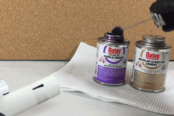

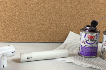

Priming
The primer solvent etches the inside slot of the pipe fitting and the outside of the pipe. The purple primer stains, like really stains, so that's why I like to work with clear primer, but for the sake of this demo, I'll be using the purple primer.
Unscrew the cap carefully. Every time I've bought a new container of cement, the lids are on so tight that I've had to initially unscrew it using a vice grip. The liquid inside the container is not very viscous and can splash out easily. Go slow.
There is a brush in the cap of the primer. Use the brush to run a thin film of primer on the inside of the pipe joint as well as the outside of the pipe you are inserting into the joint. You only need to prime as deep as the pipe is plunging into the joint, usually the same distance as the outside diameter of the pipe (or right up to the mark you’ve made between the joint and pipe).
If it pools up and begins to drip, another pass of the brush or slightly turning the pipe should stop the primer from splashing onto your work surface.
The primer dries very quickly and the cement can be applied almost immediately after the primer has been brushed on.

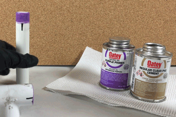

Gluing
You don't want to apply a ton of glue, but a single viscous coat of cement on each side is necessary. The cement has a swab in the top of the bottle, just like the primer. Repeat the same application process as above, swabbing the outer diameter of your pipe and the inner diameter of the fitting before joining.
Matching the marks on your fitting and pipe ensures precise alignment of your parts.
It takes a couple of hours for curing to be complete, but your bonds are ready for pressure within 10 minutes of cementing.
