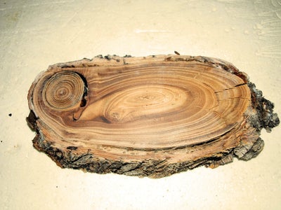

This spring I thought I would try out a new bandsaw blade and so picked up a bunch of wood that had been lying around for a few years and sliced it up. The more I cut the more fascinated I became and the next thing I knew had a pile of these amazing pieces of wood. Sometimes the adage of beauty being on the inside really proves true. Some of this wood looks like junk outside, one piece even looks like something from a litter box. Yet inside they are amazing. I started to think about things I could make with them. Elm slices have amazing color and grain. I had some that were pretty gnarled with knots and holes in them. But sometimes a hole is an opportunity to fill rather than something missing. So this crazy idea happened, to put LED's in the holes and fill the gap with something like glass that would transmit the light and then glue the entire thing together with epoxy. Why not give it a try?

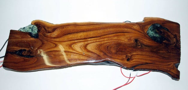

You might recognize this as being the elm slice that homer had possession of. He got tired of it pretty fast so I rescued it.

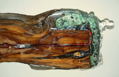

I did things differently with this one as compared with the other. After I completed the olive I liked the overall result but some of the LEDs shown through the glass very brightly. The ones that looked better I thought were the ones that were behind or concealed more so the light reflected through the glass. I decided to try to place the LEDs in better spots to get a better light pattern. So I started by only putting in half the glass and doing a beginning pour of about half epoxy.
Using a Dremel I cut channels for the wires and also cut slots to fit the LEDs into the wood. Then I added more glass and filled in the rest of the epoxy.
Step 3: I Like the Green
I think the LEd placement idea worked out well. You can see the difference in the front and back pictures.
Mixing in another color also adds some highlights that are a nice effect. Some of the green light reflects off of the glass at the far side so there are little green sparkles in with the white. The solid green knothole looks a little like an emerald. It's a nice effect overall.

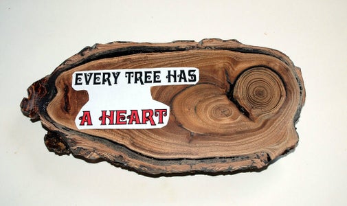

I ran across this interesting piece of elm and thought that it would be worth trying to preserve. I looks like it has a heart. Interestingly all trees have hearts, that is what the middle of the tree is called. it's a play on words, yes.
The wood was nice and dry but it had started to fall apart and the bark was flaking off. I wondered if epoxy could fix it.
Turns out it works fantastic for this. The epoxy hardens very slowly so it gives it time to soak into the wood. In fact it runs down into every little crack and it actually soaks into the wood fibers. This gives the wood a wet look. In darker woods the color can become very dark. Once hardened the epoxy becomes part of the wood and holds everything together. So if you have a piece of wood that has some rot and you want to fix it, run some epoxy into it and let it set up. It becomes harder than the wood itself. It just takes a long time to cure.
Step 5: Adding a Caption.
I thought I would get a little philosophical and add a caption, after all I already took steps to preserve this piece, lets go all the way.
I printed out a little message with a laser printer and arrange it to fit on the wood. Then using a wood burning attachment I transferred the image to the wood from the paper. This can get tricky. If it is to hot the paper will scorch. If you don't use enough pressure the image will not transfer completely. It might take a few times to get it right. if you make a mistake you just sand it off and do it again.

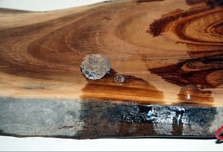

This gnarled elm required multiple coats of epoxy as most woods like this do. The epoxy does not shrink but it does fill in low spots first. So in order to get a flat top you have to build it up until all the low spots are filled in.
I had a few disappointments with this one. The first was that the lettering from the laser transfer became hard to read when the epoxy was put on it. I thought it would show through better. I think it was because the elm wood itself was so dark. It should work better on lighter woods.
Next, interestingly, the glass kind of disappears in the epoxy. Not unlike marbles in a fish tank, the epoxy hides the glass unless you look through it. So, while broken glass is all sparkly, glass in epoxy is hard to see. I suppose glitter would work better for reflecting light. But light shining through from behind does show the glass, whereas glitter would show up as just dark spots. .

This is a slice of Russian olive that I thought has some interesting holes in it from knots. A perfect place to try and add some light. Using LED's and hot melt glue, I placed the lights where I thought they would work the best. By the way, these are 12 volt pre-wired LED lights. They are really inexpensive when bought in bulk on eBay. These knots holes were open on the bottom and closed on the top so I put tape over the top and filled them with glass from the bottom. This actually worked pretty good because it kept the glass flat across the top with no pieces sticking up. I used hot melt glue to build up a dam to keep the epoxy in where there was no wood. This worked better than I thought it would. I put the tape on top first and then put the glue on the tape where I needed it. This made it possible to pool the epoxy in the glass in places that didn't have wood for a border. Once it is set the epoxy supports itself.
After the epoxy cured I used a hair dryer to heat up and remove the hot melt glue, dabbing it up with a paper towel when it melted. I have to remember this trick as I could see it being very useful. Essentially you can make a mold with hot melt glue, fill it with epoxy and then melt the glue out, especially since epoxy isn't bothered by the relatively low heat.
So, I turned the olive upside down and poured the epoxy into the knots and let it set. Then removed the tape from the top and finally put a top coat on top after I had removed the hot melt glue dam's.
