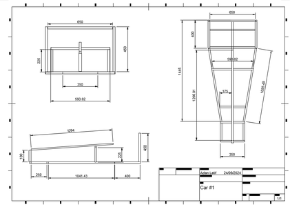

Material:
  1. Using these measurements in the orthographic, acquire steel box section of 22x22mm.

Step 1: Measuring
Using either a ruler or tape measure, measure out the lengths specified in the orthographic. Use an engineer's square or sliding bevel gauge for either 90 degree cuts or angles, and mark out using a scriber.
*TIP* - Always measure 2mm more material than you need! It's better to go over and have to cut down than remake a part.
