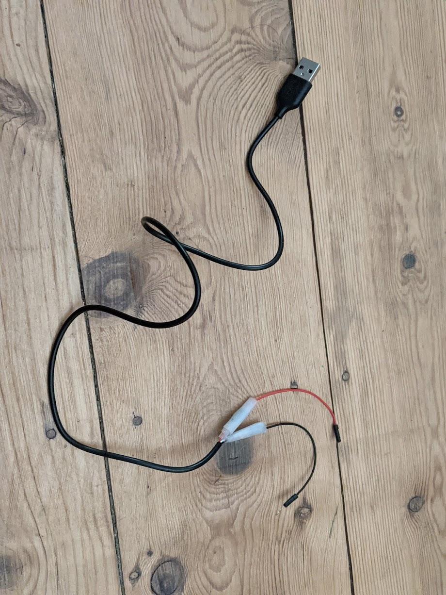

Step 2: Make 3 X Micro USB Cables
- To power the Arduino, you need to strip a USB cable and wire this to the breadboard. I separated the + and - wires then soldered them to breadboard cables. I then shrink wrapped over the solders (picture was taken before I shrink wrapped)
- You will need three of these cables: 1 to power the Arduino and 2 to make a cable to power the GoPro
Step 3: Make GoPro Charge/relay Cable
- Using 2 of the micro USB cables, solder the negative terminals together and shrink wrap. connect USB cable to GoPro with USB to MICRO USB adapter.

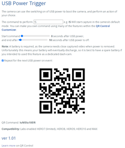

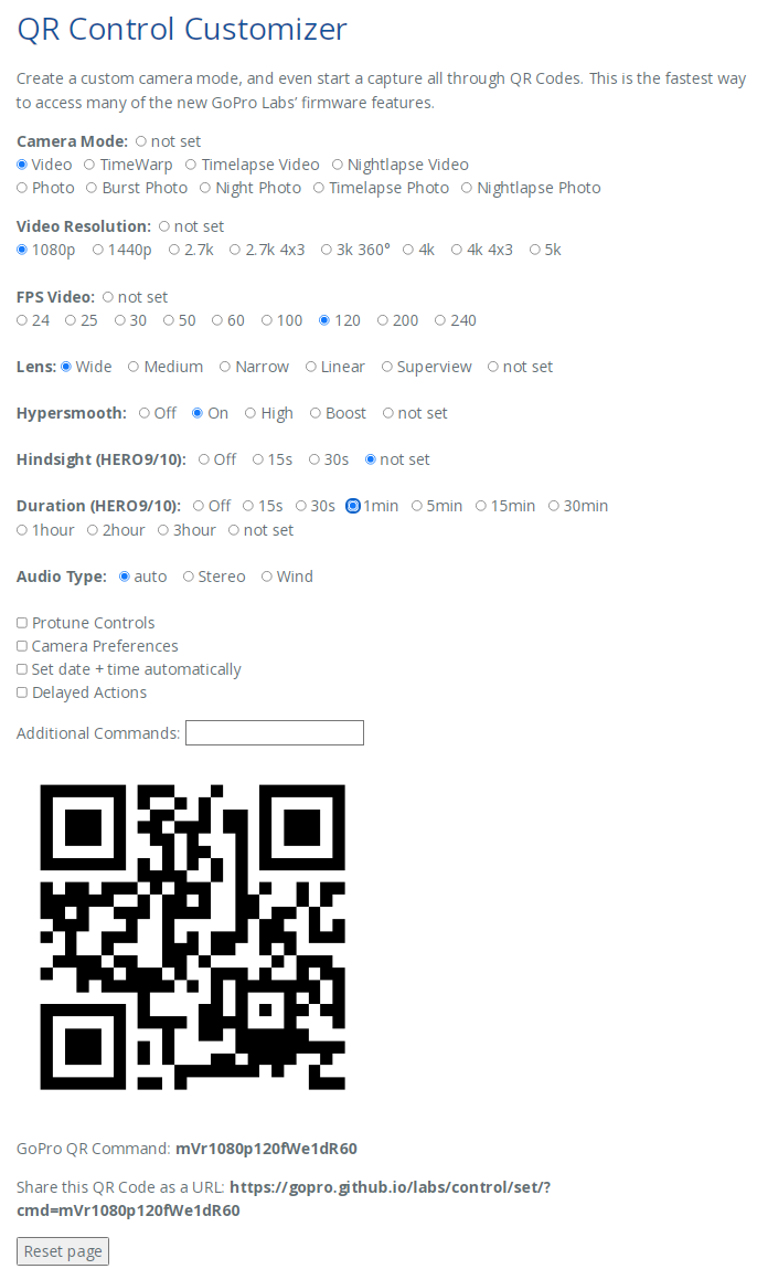

Step 5: Install GoPro Labs Firmware
Next, we need to make the GoPro record when it receives power.
- go to https://gopro.github.io/labs/control/usb/ and set the parameters how you wish.
- scan the QR code with your GoPro and it will download the settings

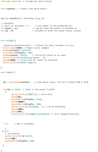

Step 6: Code
The code is very simple. Here's how it works.
- Read sensor.
- if sensor value is high; trigger relay
- else { do no nothing }
The rest of the code is there to serial print what is happening.
