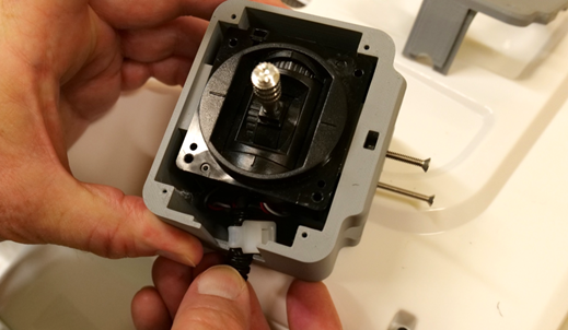

5.19. Cut the plug off the joystick (9) and strip half an inch of insulation off of each of the six wires. The wires are so thin that it may be easier to use a thumbnail to strip the wire instead of a wire stripper.
5.20. Strip a quarter of an inch of insulation off of each wire on one end of the four wire ribbon cable (10).
5.21. Put a piece of small heat shrink tubing (6) on each wire of the four wire cable (so it will be there after you solder).
5.22. Solder the two red wires from the joystick to the red wire of the ribbon cable.
5.23. Solder the two black wires from the joystick to the black wire of the ribbon cable.
5.24. Solder the white wire that comes from the side of the joystick (y axis) to the green wire of the ribbon cable.
5.25. Solder the white wire that comes from closer to the center of the joystick (x axis) to the blue wire of the ribbon cable.
5.26. Shrink the heat shrink on the 4 solder joints.
5.27. Drop a 4-40 nut (11) into each of the two slots on the 3D printed joystick holder base piece (101). Check that you see the holes in the nuts though the holes where the bolts will go. If the nut does not fall completely into its slot (i.e., if the hole in the nut does not completely line up with the hole in the joystick holder base), you may need to the point of a nail or screw into the hole in the nut then push the nut into place). To keep the nuts in place for now, screw the 4-40 1 ¼” machine screws (12) into the nuts.
5.28. Fit the joystick into the 3d printed joystick holder lid (102), it should fit in only one orientation.
5.29. Put the wire protector tube (13) around the four wire ribbon cable (10), with a couple inches of wire showing between the joystick and the wire protector. Tighten a large zip tie (30) around the end of the wire protector closest to the joystick, about ¼” from the end of the wire protector (the zip tie will provide some strain relief, preventing the wire from being pulled out of the joystick holder).
5.30. Fit the 3D printed joystick holder lid (102) and base (101) pieces together, with the end of the wire protector tube and the zip tie going inside the box.
5.31. Secure the lid with four m2.2x14mm screws (14) using a Torx (star-shaped) T6 screw driver bit, making sure to hold the lid down tightly as you put the screws in. It might be helpful to drill out the four holes using a 1/16" drill bit first. It also helps to partially tighten each screw before fully tightening any screw.
