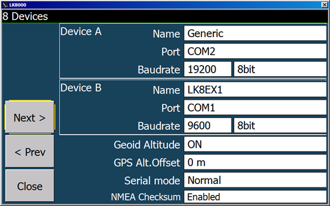

Arduino board creates NMEA like protocol with variometer output and beping sound.
LK8000 EXTERNAL INSTRUMENT SERIES 1 - NMEA SENTENCE: LK8EX1
VERSION A, 110217
$LK8EX1,pressure,altitude,vario,temperature,battery,*checksum
Field 0, raw pressure in hPascal:hPA*100 (example for 1013.25 becomes 101325)
no padding (987.25 becomes 98725, NOT 098725)
If no pressure available, send 999999 (6 times 9)
If pressure is available, field 1 altitude will be ignored
Field 1, altitude in meters, relative to QNH 1013.25
If raw pressure is available, this value will be IGNORED (you can set it to 99999
but not really needed)!(if you want to use this value, set raw pressure to 999999)
This value is relative to sea level (QNE). We are assuming that currently at 0m
altitude pressure is standard 1013.25.If you cannot send raw altitude, then send
what you have but then you must NOT adjust it from Basic Setting in LK.
Altitude can be negative. If altitude not available, and Pressure not available, set Altitude
to 99999. LK will say "Baro altitude available" if one of fields 0 and 1 is available.
Field 2, vario in cm/s
If vario not available, send 9999. Value can also be negative.
Field 3, temperature in C , can be also negative.If not available, send 99
Field 4, battery voltage or charge percentage.Cannot be negative.If not available, send 999.
Voltage is sent as float value like: 0.1 1.4 2.3 11.2. To send percentage, add 1000.
Example 0% = 1000. 14% = 1014 . Do not send float values for percentages.
Percentage should be 0 to 100, with no decimals, added by 1000!

Step 6: What Next...
Last thing to do is setup LK8000, to be able to understand what Arduino is saying. Also we have to setup few things to meet our flying requirements.
All details how to setup LK8000 software are available on my project website
https://sites.google.com/site/jarosrwebsite/para-nav
