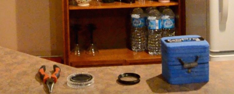

Materials
- GoPro Dive Case
- 55mm Filter (That you don't like)
- 55mm Filter (That you do like)

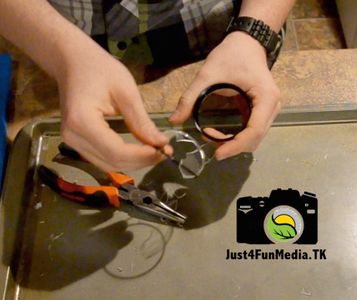

Step 1: Sacrafice a 55mm Filter
I sacrificed a scratched and chipped 55mm Saturn filter. Break the lens over a garbage pail or tray and remove the shards with pliers. Make sure not to damage the lens casing or retaining ring.

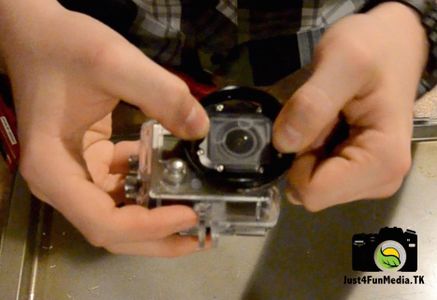

Step 2: Pop It On
Place the empty lens casing over the dive case lens (threads towards the GoPro) and pop the retaining ring back into the casing. I needed to use the pliers to force it back in.

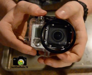

Step 3: Screw on Your Favorite Filter
It is now time to screw on your favorite filter and test out your GoPro. I have found that polarizers can do wonders for hard to expose areas such as cycling or skiing through trees (see above images).
