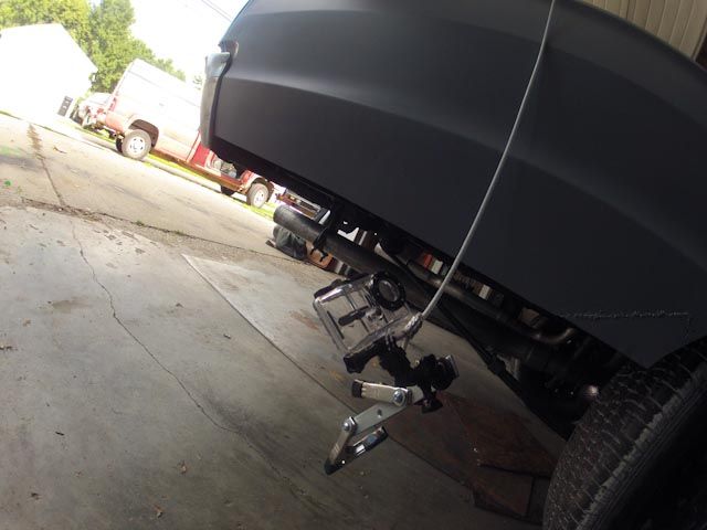

Step 6: Mounted on Vehicle
Here they are! You'll notice they have the safety cable attached to them, it didn't end up using it but it provided a little peace of mind.
