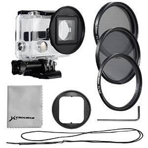

Step 3: Find a Lens Adapter
I then ordered a 52mm lens adapter for the camera. I also went to Amazon and found one that came WITH a UV lens and a couple extra filters. mainly for protection more than for their intended purpose. (About $12)

I then used a utility knife to cut a square hole in the box, small enough a to barely squeeze the adapter through so that it would snugly fit without glue. I then used marine waterproof caulk to seal any gaps.
