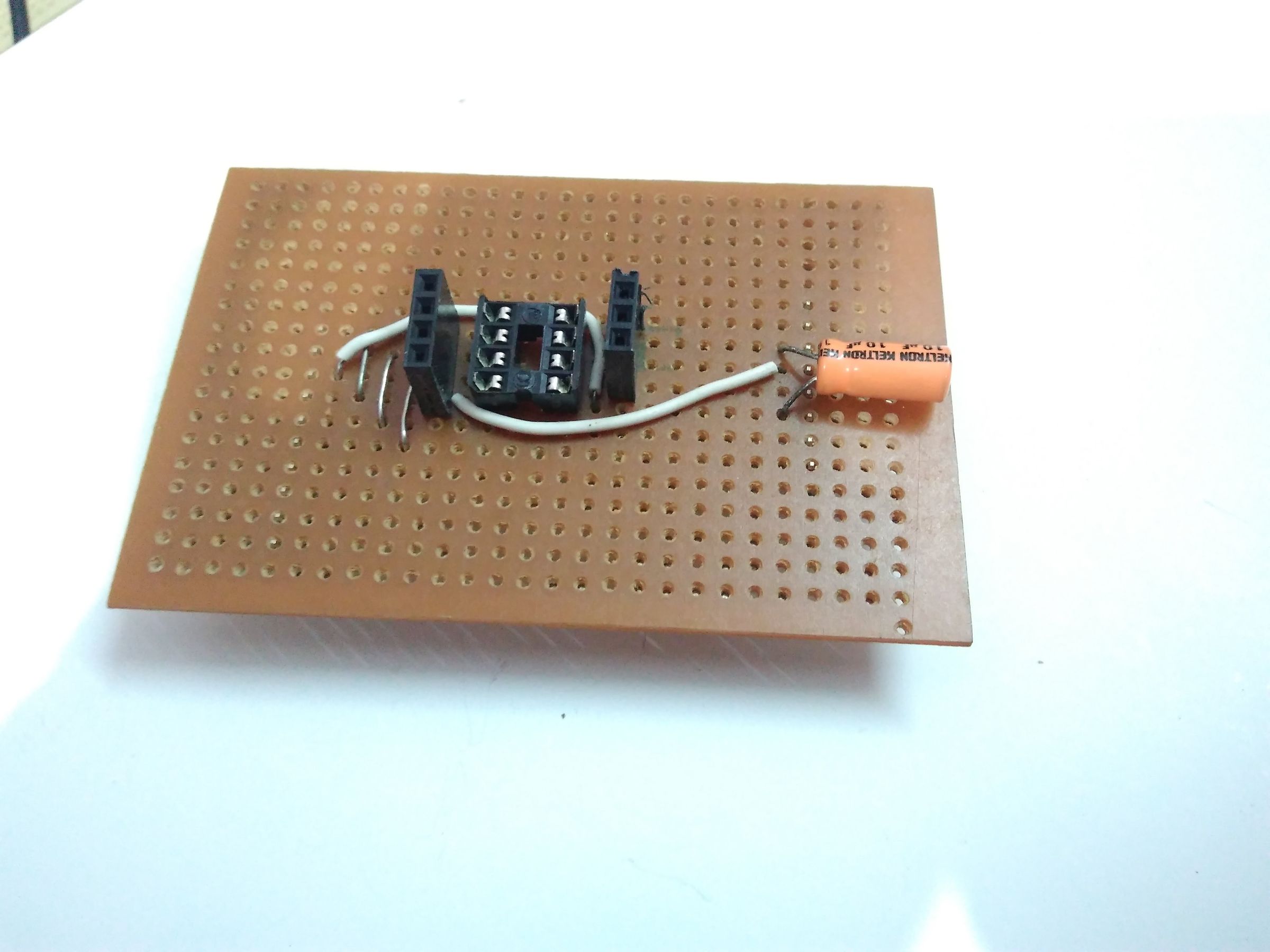

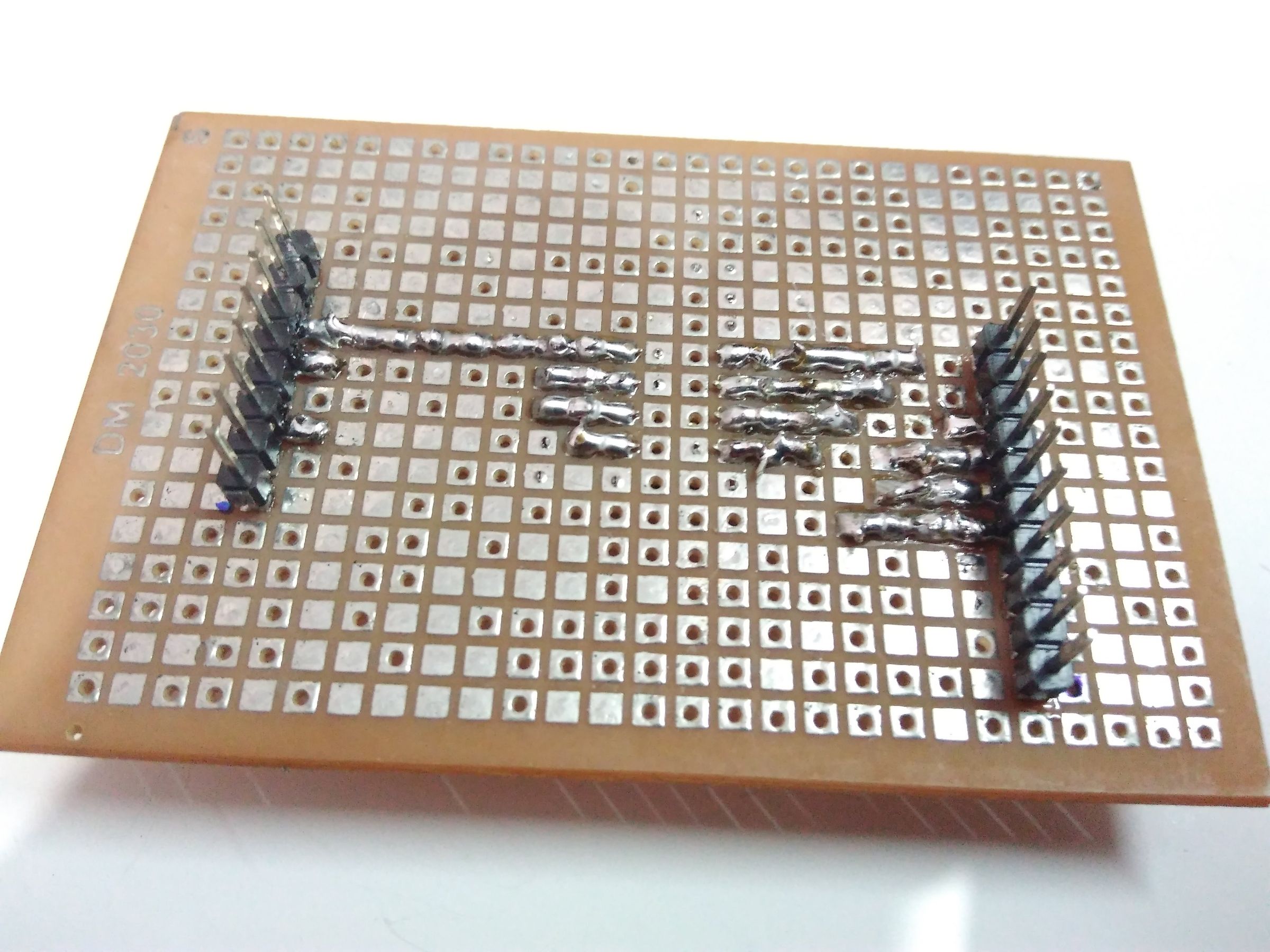

Step 3: Making It
- Put the LED's in and place the components at the required positions on the board (I've left space at the bottom of the perforated board for future upgrades).
- In order to ensure that the part stays in place when we turn it face down (for soldering), I used some hot glue to do that. I find this easier than bending all the leads.
- Solder the components onto the board.
- Now make connections using solder and wires.
- Verify all connections with a multimeter
- Remove the hot glue
- Program the ATTINY85 with the code given below
- Board: ATtiny25/45/85
- Processor: ATtiny85
- Clock: Internal 8Mhz
- Programmer: Arduino as ISP
- Test it
