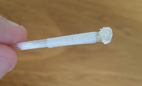

Step 8: Fiber Optic Filament
While Smaug dries, you can prepare his "fire".
Take a few strands of fiber optic filament. This can be found in rolls on ebay or in some craft stores.
Cut pieces of varying lengths, no longer and 5-6 inches. Gather them like you would a bunch of flowers, making sure that the ends on one side are all flush. Use a small piece of scotch tape to bind the bunch together at this base.
Now take a dab of your clear drying adhesive, like E-6000, and apply it to the base where all the strands are joined. Try to ensure all fiber ends are caught in this glue. After it has dried, very carefully remove the tape. You may lose one of two strands that didn't sink into the glue, but overall you should end up with an intact cluster of fiber optic filaments.
